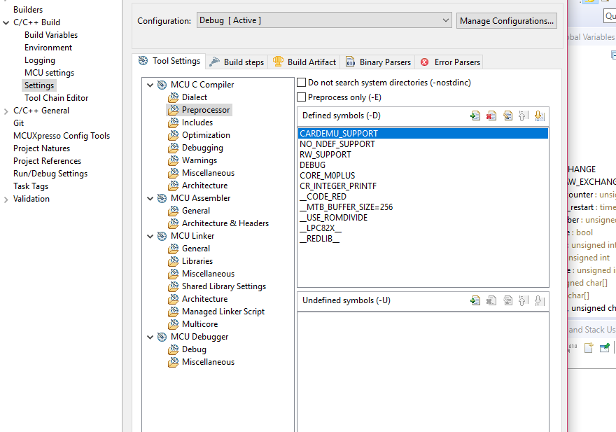

abalogh
Hello Mario,
below is a screenshot of the Preprocessor-Settings I have been using as of late for the PN170-Example-Project
Besides the settings I had mentioned in my last post;
- I have removed DEBUG_SEMIHOSTING symbol since redirecting the Trace-Output to Serial/COM output allows the program to perform faster and with better success in communication
- I have defined the NO_NDEF_SUPPORT symbol, as  I am only interested in performing Raw exchanges (Non-NDEF) of data between the PN170 and other NFC-Devices
But even with these symbols as defined, the issue as I'd reported still persists.
