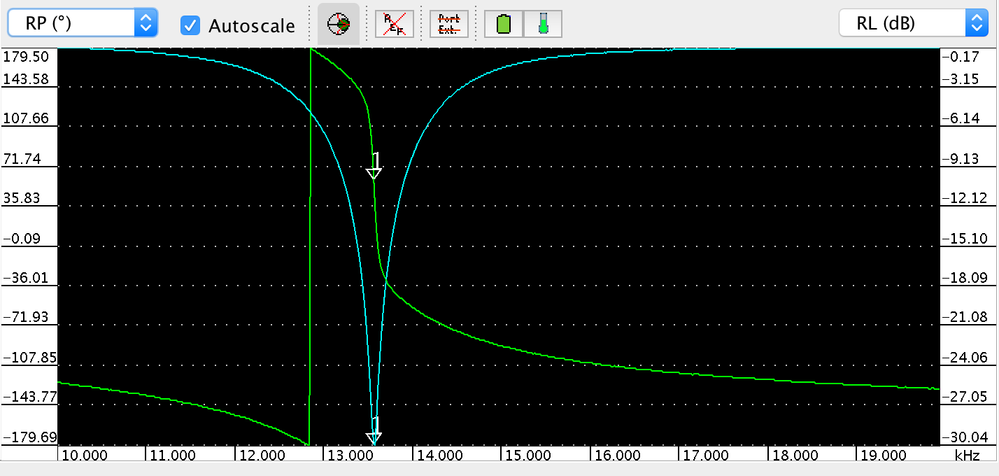

Dear NFC community members,
I am working on designing a small RFID reader circuit that is based on the PN532 chip and I would like to get some feedback. My background isn't RF engineering, so I am not sure about many things.
I'll summarize the main questions first, and then describe in details what I've done:
I am using miniVNA Tiny for taking measurements.
Q1: which parameter (SWR, RP, RL) should I look at for figuring out the self resonance of a circuit?
Sometimes the sign flip of RP correlates well with the minimum of RL and SWR, but not always.

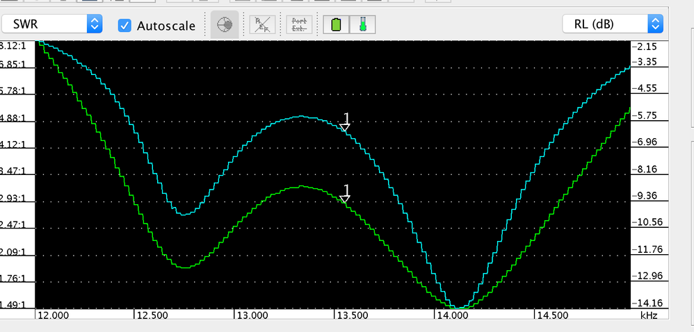

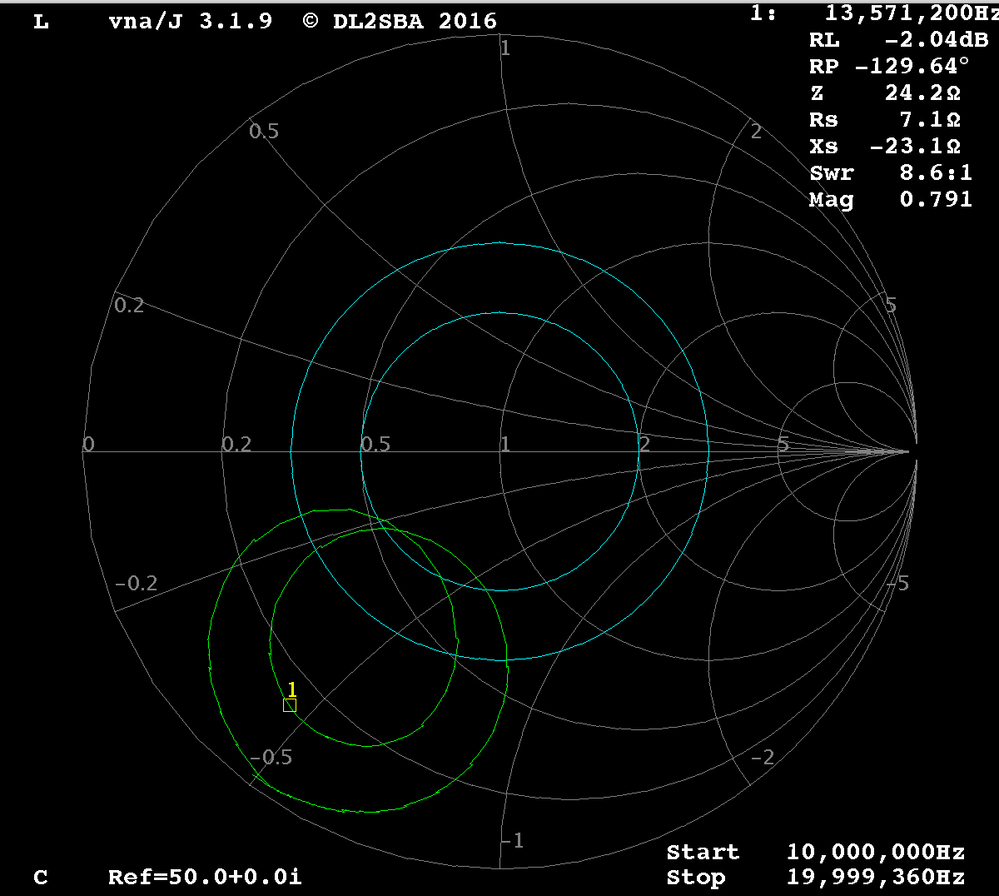

Q2: Why after tuning my antenna to 13.56 Mhz (based on SWR or RL measurements) do I see a huge shift in resonance frequency when I bring a tag close to the antenna? Typically, two peaks appear: one at ~12.8Mhz and one at ~14.3Mhz? Is this normal?
Before:
After a tag is nearby:

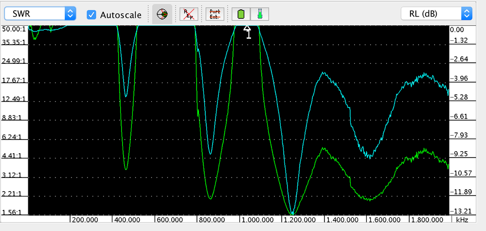

2. Measure antenna self resonance.
I looked either at the sign flip of RP or SWR.
I noticed multiple peaks, which one should I consider to be the resonance?

1. When I increase C1, I get a narrower profile (smaller arc on Smith Chart)
2. Increasing C2 generally doesn't change the radius of the arc much, but shifts the resonance frequency downward.

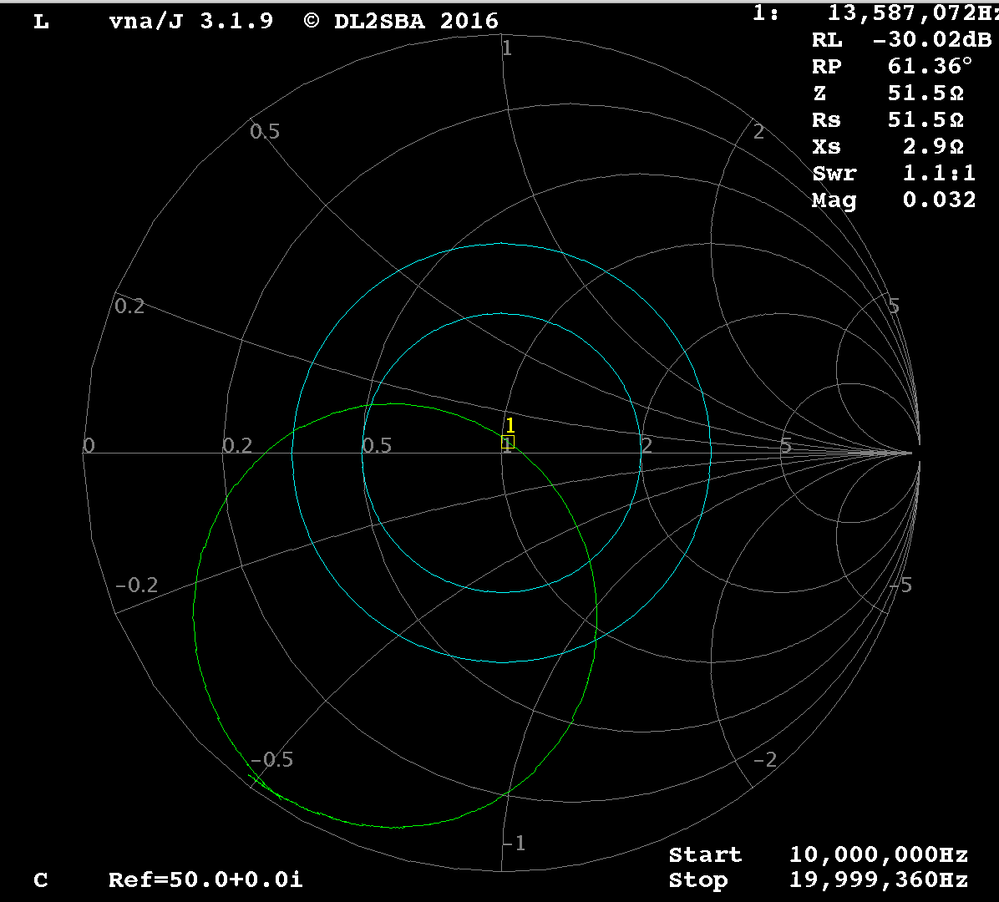

I ended up with this:
Does this look reasonable? If so, why do I get such a huge detuning when a tag is near by?
[Answer] It is normal when a tag/card or other metal circuit close to the antenna. The coupling effect will detune the original matching.
