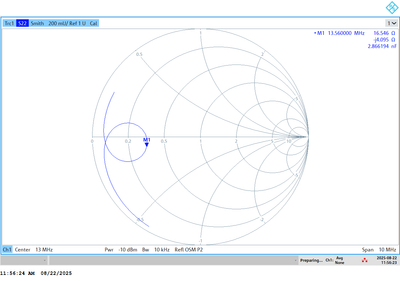

Currently I am trying to get the PN5190’s DPC calibrated. I purchased a set of PICC reference cards. https://www.comprion.com/shop/iso-10373-6-test-picc-class-1-6.html
I matched my antenna to ~16.5R (See the added smith chart).
The target current in unloaded condition is set to 246mA this is the maximum I am getting. (I would expect this to be much higher around 5.7V/16.5R ~345mA)
I now encounter the issue that when I am trying to read an NXP desfire EV1 card without the DPC calibrated I am getting 7.5 cm detection and 5.5cm read distance.
However with the DPC calibrated I only get 3.8cm detection and 2.3cm read distance. I would prefer it to have more read range. Is this to be expected or am I doing something wrong during calibration?

Hello @sinu52
Hope you are doing well.
The target power transfer of 5.3 V with TestPICC1 is only one example, typically it makes sense to use values around 5.5V. The limits are defined by EMVCo specification.
I will recommend you taking a look at the PN5190 Dynamic Power Control Quick Calibration and TxShaping Demo | NXP Semiconductors. This training series demonstrates a quick calibration of the PN5190 DPC by using NFC Cockpit and an EMVCo test setup to measure the power transfer to perform the compliance tests.
Eduardo.
