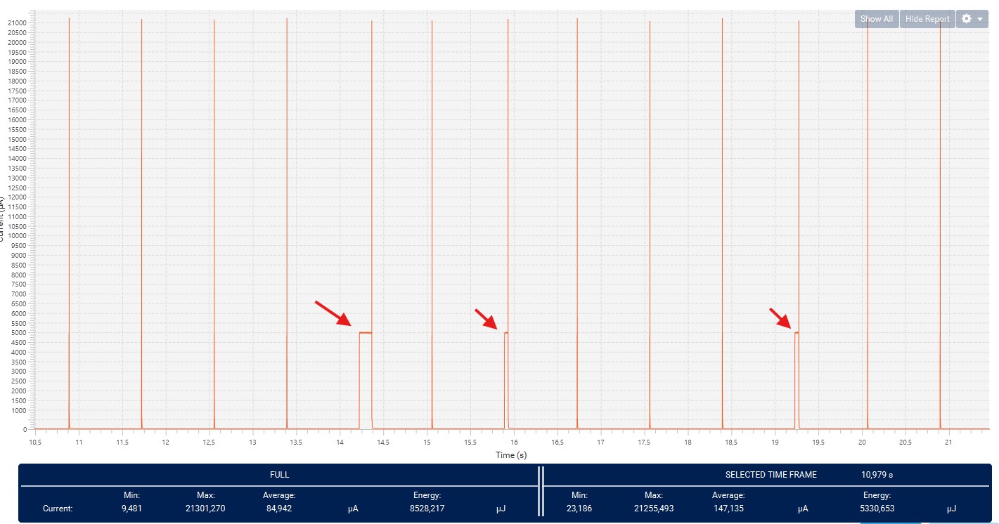

Hi, we've been working with the RC663 in a LowPower project, and after producing 200 pieces of our antenna PCB, which has the RC663 mounted on it, we noticed the following:
When in LPCD mode, most of the RC663 consumes around 1750uA per detection pulse, what is totally OK, as the average consumption stays closely to 50uA.
But, few boards, the detection pulses goes as high as 5000uA. A little bit of variation (peaks at 2300uA) can still be accepted, as the average consumption stays under 70uA, but those 5000uA peaks makes the average consumption too high.
These 5000uA pulses are also often larger and do not have a fixed frequency of occurrence, repeating sporadically more often over time.

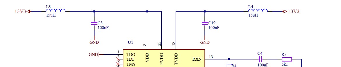

All those previous results and screenshots from my old posts were using the original connections (see Attachment Original_SCH_Power), where a singla 3V3 power source was connected to both VDD and TVDD.
When measuring only the RC663 consumption on both VDD and TVDD, as on the Original_SCH_Power, but without the extra circuit which contains the ST MCU and etc, the extra random length 5mA steps before the peaks can be seen.
To test only TVDD, I've modified the circuit as shown on the attachment (see Mod_SCH_Power), and measured only the TVDD.
For my surprise, those extra 5mA steps before the peaks cannot be seen anymore on the measurement, but what I noticed were some random time interval between few pulses (see Attachment Only_TVDD), which may indicate that:
- 5mA step is still there, but doesn't come from the TVDD
- and/or maybe the RC663 is taking too long to start?!?!
The AN11783 shows a combined StartupA + StartupB time of around 425uS, but in one of the cases I cold measure (see Attachment BadPeakClose), the 5mA step was active for around 30ms.
Regarding your question about the RF field duration, I'm afraid I don't have the right equipment to measure that. My colleague checked the antenna matching, and the results were totally OK, but he was not sure how to perform such test. From power consumption side, all the peaks looks the same (as on my previous Attachment BadRandomPeaks).
So far, seems that the extra power consumption comes from the VDD pin, but why it happens randomly (and seems to get worster/often by the time) is not clear.

Based on your measurements, it looks like the "longer" pulse is caused by VDD (the main power supply of RC663).
Also, it looks like the RF field is not even generated (I see missing current peaks in the TVDD waveform) when this abnormality happens.
It looks like the IC tries to start up and perform the LPCD RF ping, but the start-up takes significantly more time, and the RF is not generated. Then the IC continues into the LPCD standby mode, and then with the next LPCD Ping, that is OK.

I'm using the RC663 together with a ST MCU, via SPI, which goes to deep sleep mode and only wakes when RC663 set the IRQ pin.
Attached you can find the antenna schematic in use.
I'm not using the NFC Reader Library, as it won't fit with the rest of the code into the device's memory, but the function to enable the LPCD mode follows all the steps from AN11145, including reading and writting all registers shown on the doc, and calculating QMin, QMax, IMin values according to the formulas.

I've increased the sampling frequency to 10KHz, and I could see that, indeed, the peaks go up to 18500 - 21500uA for a really short time. But by increasing the sampling rate, I could also notice two totally different peak patterns (See Attachments), when comparing a RFID board which has an average consumption of 38uA against another one with 150uA (consumption varies, as the large pulses occurs sporadically), sharing the same code and schematic.
Do you know what could cause that difference between both "good" and "bad" peaks? And why those "bad" pulse are not constant, but happens in between some "good" pulses randomly?
