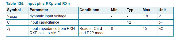

In the document "AN11740 - PN5180 Antenna design guide" section "4.5.1 External Rx components", it mentions that the resistors R1A and R1B are typically in the range of "1...10kΩ". Does this mean 1kΩ to 10kΩ or 1Ω to 10kΩ?
Is there a risk in going outside this range and using a very small resistor value like 100Ω?

"1...10kΩ" means 1kΩ to 10kΩ, using another value out of this range might cause the dynamic input voltage on RXN and RXP out of spec. Please refer to the following for details.

The typical value is from 1k to 10kohm, but the final exact value will depend on the final use and the antenna design, right?
We tried to use 1kohm, but we found a problem. Sometimes, the communication distance from our antenna to the bottom of our phone could be just ~3-5mm, but sometimes >15mm. We tried many rounds we also had this symptom. In fact, there is an existing gap ~3mm from our antenna to the top surface of our casing cover. If we just use 1kohm, we worry the sensitivity will not be very stable, the worst case may not communicate.
We also tried to use 100ohm. This value seems without the mentioned symptom. 100ohm can keep the communication distance from the top surface of our casing cover to the bottom of our phones >5mm every time. This also meets our requirement. The basic required communication distance is ~5mm(min) from the top surface of our casing cover.
Do you have any idea or provide more advises for using this value?

Actually https://www.nxp.com/docs/en/application-note/AN11740.pdf  provides the way how to choose the RX resistor value, please kindly refer to 4.5.1 External Rx components for more details.
