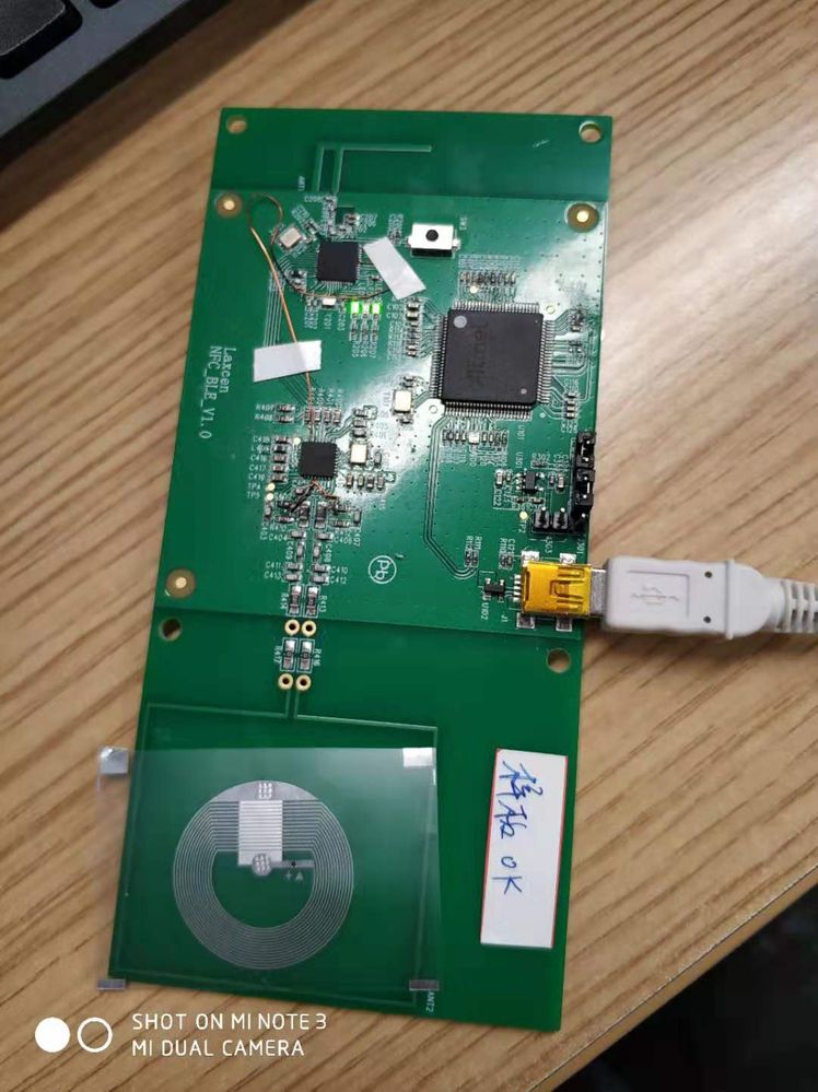

I'm an android developer and I'm trying to develop an app to connect this board,here is a picture of my board.
My board: QN9020+CLRC663(BLE+NFC)
The tag is the bottom left on the board.

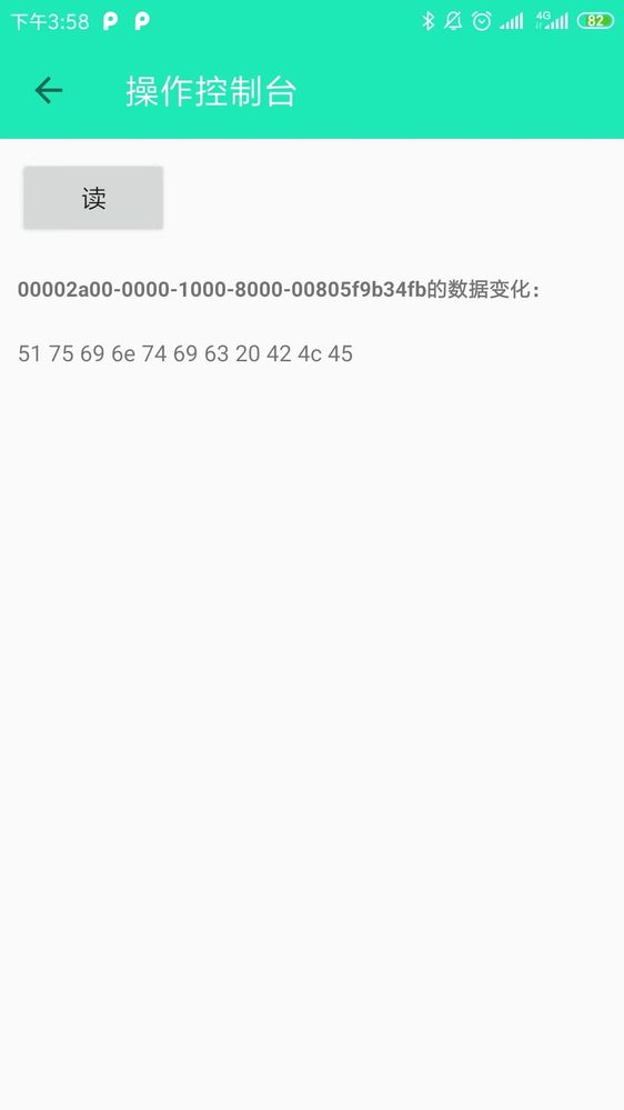

Through my App, I can successfully scan and connect the board,but I can't read any information returned by the NFC.

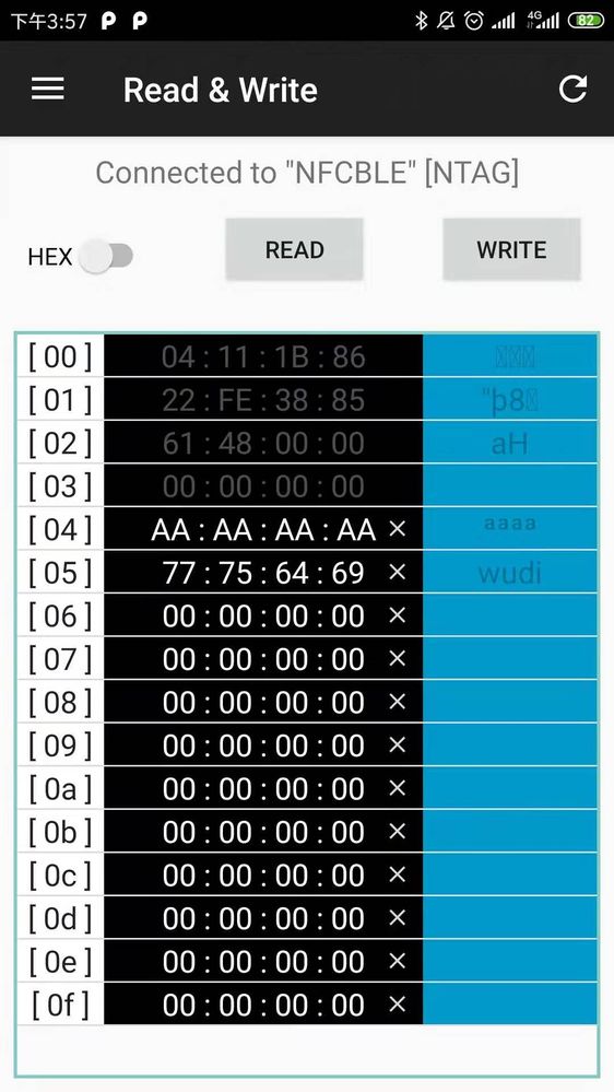

But I can read/write successfully with the BLETool you provide,here is the picture
After BLE connection, do I need to send some instructions to receive the tag information read by NFC?

If you are using your own board and it does work with the default source code with the NXP application the issue is most likely that your application is not receiving or interpreting in the correct way the information sent by Bluetooth LE you will need to check the format used to sent the information and translate it correctly to your needs in the mobile phone.

You can try to use an sniffer to check/verify  the Bluetooth  communication and you can see how the packets are being sent.
