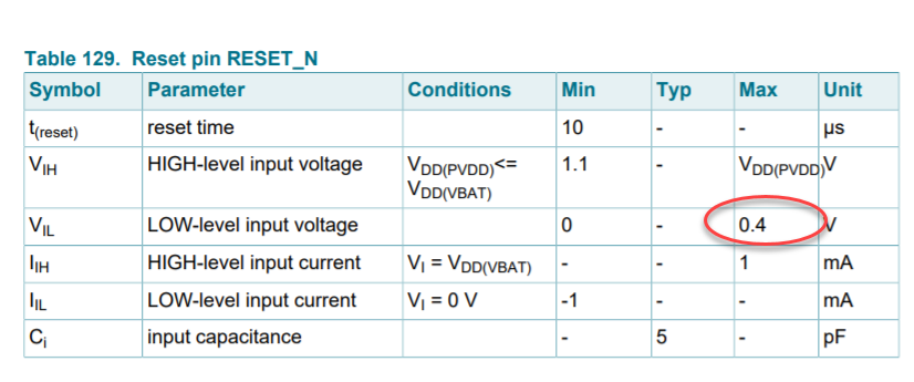

Hi.
I have a question about PN5180.
In datasheet, There isn't IO pin ratings at The Limiting value.
All VIL is 0V at The Characteristics. Do I need to follow this?
Isn't it acceptable for minus tens of mV?
Thank you anyway.

Hi Shiori Sugawara,
The data sheet specifies the VILs to 0V, so I think better follow the spec, otherwise you have to take your own risk.
Kan

Hi, Thank you for your advice.
Sorry, That's not the answer I was looking for.
I'd like to know minimum limit.
Many IC chips can apply a minimum limit of -0.3V.
I think that PN5180 also can apply -0.3V, but I can't find it.

Kan_Li
Hi Shiori,
I am not sure which version of data sheet you are referring to, but the latest version has the data you are looking for, for example,
Please kindly refer to https://www.nxp.com/docs/en/data-sheet/PN5180A0XX-C1-C2.pdf  and https://www.nxp.com/docs/en/data-sheet/PN5180A0XX-C3.pdf  for more details.
Hope that helps,
Kan
