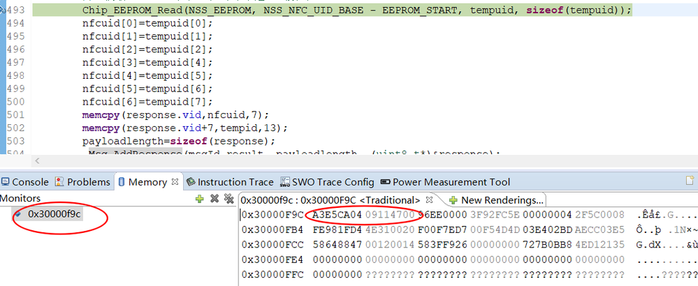

dear all
   I read nhs3100 nfc ID from the eeprom with address
#define NSS_NFC_UID_BASE (EEPROM_START + 0xF9C) /*!< Base address of the NFC unique ID (same value can be found in the NFC tag header and read via NFC) */
the result is : 04 CA E5 A3 00 47 11 09

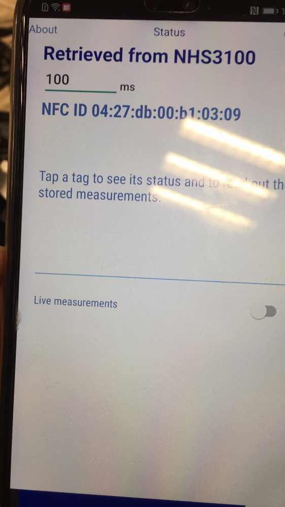

but I read from the phone APP NHS3100 TLOGGER ,
the result is  : 04 27 DB 00 B1 03 09
can you tell why the ID is not equal ?

thomas_pawlik
MSG_ID_GETUID = 0x09,
* @c 0x0a @n
* Retrieve the NFC identifier of the IC. This is the serial number assigned to the NFC controller and stored in
* the first two pages of the NFC shared memory.
* @note This is a random number assigned during production of the IC. It is @b not guaranteed unique among all
* NHS31xx ICs.
* @note This is @b not equal to the device UID.
* @param Header : Sequence of bytes as per the @ref msg_anchor_protocol "Protocol".
* @param Payload : @b No payload.
* @return MSG_RESPONSE_GETUID_T
* @note synchronous command
* @ifnot MSG_PROTOCOL_DOC
* @note Enabled by default. To disable this command, undefine #MSG_ENABLE_GETNFCUID.
* @endif
MSG_ID_GETNFCUID = 0x0a,

yes ,I tried ,also the same result .
in fact ,the API is also called this function .
static uint32_t GetNfcUidHandler(uint8_t msgId, int payloadLen, const uint8_t* pPayload)
MSG_RESPONSE_GETNFCUID_T response;
ASSERT(msgId == MSG_ID_GETNFCUID);
(void)msgId; /* suppress [-Wunused-parameter] */
(void)payloadLen; /* suppress [-Wunused-parameter]: no argument is expected, but if present redundantly, just ignore. */
(void)pPayload; /* suppress [-Wunused-parameter]: no argument is expected, but if present redundantly, just ignore. */
Chip_EEPROM_Read(NSS_EEPROM, NSS_NFC_UID_BASE - EEPROM_START, response.nfcuid, sizeof(response.nfcuid));
Msg_AddResponse(msgId, sizeof(response), (uint8_t*)&response);
return MSG_OK;
can you give me more suggestion about this problem ?
