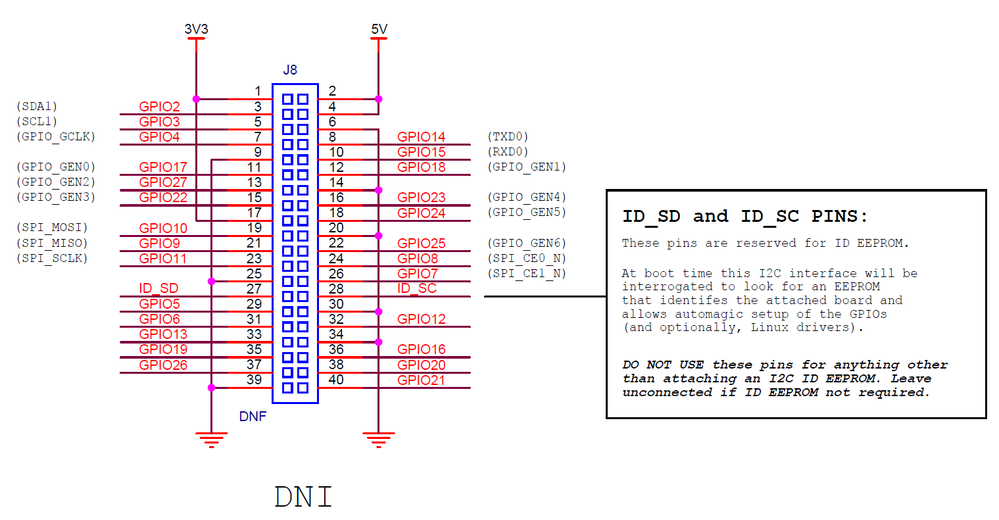

OM5578/PN7150RPI is compatible with Raspberry Pi Zero W or not?
If not does any other NFC development board could support Raspberry Pi Zero W?

There is no change in the definition of 40 pin GPIO port, so OM5578/PN7150RPI is compatible with Raspberry Pi Zero W.
