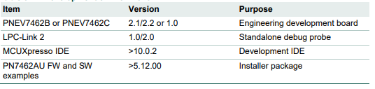

One more clarification , do we need any additional board along with OM27462CDKP development kit to work with all sample applications provided "PN7462AU FW and SW Examples Full Version - v06.10.00"
Thanks and Regards
Sreevishakh
4,652 Views
Daniel_Gutierrez
Hello @sreevishakhkp, Good Day!
In order to work with the code examples provided within the library you would only need the following components:
These are all included in the OM27462CDKP development kit (which contains the PNEV7462C version of the board), so there is no need for additional hardware.
Keep in mind that "PN7462AU FW and SW Examples Full Version - v06.10.00" is an older version of the library, we recommend using the most recent version of the software which is available for download here: NFC Reader Library | NXP Semiconductors.

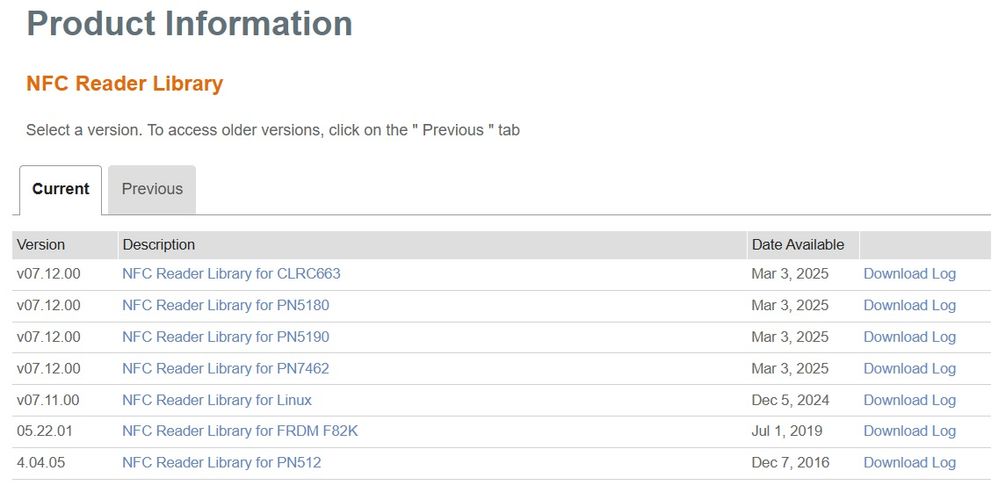

sreevishakhkp
Hi Daniel
Thanks for your update. I am not able to find NFC libraries for  PN7642 . Can you please help in for NFC library.NXP.jpg
4,462 Views
Daniel_Gutierrez
All the available example applications of the PN7642 including NFC examples are contained in the PN7642 MCUXpresso SDK which can be found in the PN7642 Product Page under Design Resources along with other relevant software packages. Please refer to the PN76 family evaluation board quick start guide to get a deeper understanding of the software and hardware configurations to be made in order to start developing with the OM27642EVK kit.
