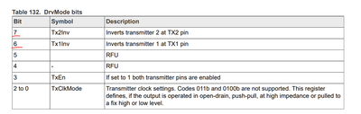

Hello hengma,
You should be able to change the phase of the TX signal using the following register. If both signal are in phase (TX1 and TX2). You should be able to connect them and get proper signal and waveform.
Tomas

In order to use a single-ended transmitter solution, shall I configure both Tx1Inv and Tx2Inv to 1 or 0? In this case, both TxN and TxP will deliver a non-inverted or inverted 13.56 MHz carrier, which is in phase.
Also, may I know the setting of TxEn? Can we define the source of the transmitter using the setting of TxEn?
Heng

Hello @hengma ,
Correct, Once both Tx paths are anabled and they are in phase. The maximum power of the TX driver can be used.
If only one TX side is enabled (TxEn), the power is reduced by 50%.
Tomas
