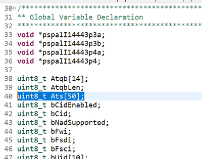

Kan_Li
Hi @troky ,
A good example for reference regarding this kind of operation is the demo of "Nfcrdlib_ISO10373_6_PCD_ComplApp", in which an array is defined globally for this purpose.
You may fetch the latest version (should be 6.12.00) of "NFC reader library" for more details.
Kan
