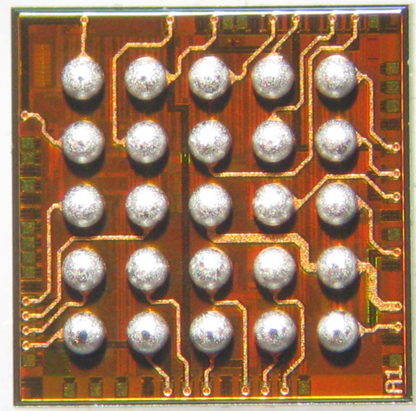

The UK suffix indicates the package used is the WLCSP25 (2.51x2.51x0.5 mm): pastedImage_1.png
This is not a human-solder-friendly package, to put it mildly.
For a thesis, you're far better off using the HVQFN24 package (4x4x0.85 mm):pastedImage_2.png
