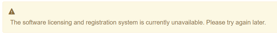

To clarify, I need to download the MCUXpresso IDE, and use that to flash that binary onto the cockpit hardware? Is that correct?
I can't seem to download the MCUXpresso IDE. See the error message below when I click on "download"
Any help?

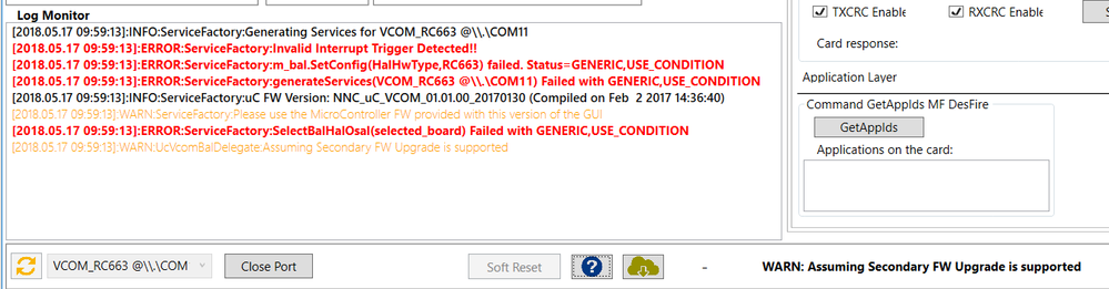

robhelvestine
Also IvanRuiz‌,
Here is my log screen when I plug in the Cockpit tool:
Just want to make sure there is nothing else preventing me from using the tool. Thanks.
