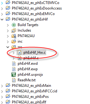

Dear All,
I am new to PN7462 and working on  PN7462 Development board. I want to implement HSUART protocol  independently for one  product. I also  refer  example PN7462AU_ex_phExHif  from SDK but I get confused that how can start from very basis steps like Setting Clock, GPIOs for HSUART and Initialization etc. I request you to please guide me and If any one have sample code than refer to me so I can get better idea about HSUART. Thanks to All in Advance.

Hi Amol,
The clock settings can be found in phFlashBoot_HwSetup(), and GPIOs for HSUART and Initialization can be found in the source file of "phExHif_Hw.c":
Please refer to "14.3.3 High speed UART" in the attached UM for more details.
Hope that helps,
Kan
