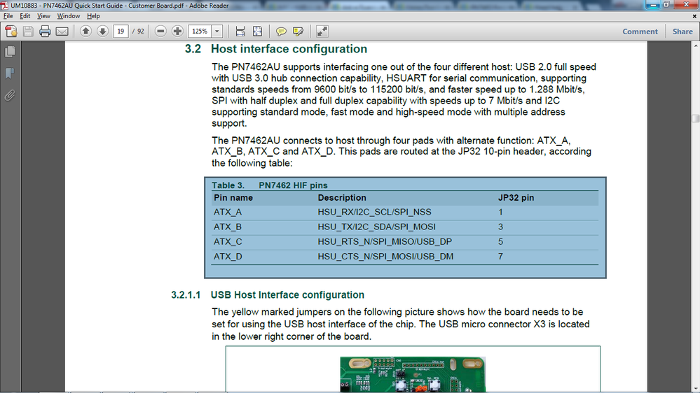

Interfacing an external host with PN7462B V2.2 Development board- The HIF pin details given in the Quick start guide for connecting the host is seen to be missing the SPI_SCK pin detail and the SPI_MOSI pin is seen to be repeated twice.
Please find attached the screenshot of the document.
Request you to provide clarification on the host pin detail (JP32) of the PN7462 development board(PNEV7462B V2.2)

Yes, that is a typo. I already informed internally to correct it. Meanwhile, please refer to table 4. of the data-sheet for a clear description:
https://www.nxp.com/docs/en/data-sheet/PN7462.pdf
