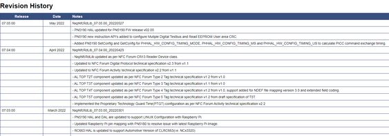

I want to know the difference between NFC Reader Library for PN5190 and Linux.
The latest library version is following
- for PN5190: v07.05.00
- for Linux: v07.03.00
If I want to develop in Linux environment, does it need to use v07.03.00?
If Yes, is there any risk about not using v07.05.00, and how to support PN5190 FW v2.05?
(It looks for Linux doesn't support PN5190 FW v2.05)

pleaser refer to the revision difference
The new features in Reader Library v7.05 is related with PN5190 firmware 2.05.
I would suggest you start with Read library v7.03 , and merge the new features in v7.05 into your project,    then you can use PN5190 v2.05.
I will ask internally when the reader library v7.05 for Linux will be ready.

OK understood.
I will try to start with Reader Library v7.03 and PN5190 v2.03.
And after released, replace updated one.
Did you get information about v7.05 for Linux?
2,817 Views
danielchen
it is not ready. I will keep you informed.
