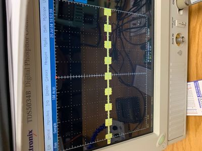

Here is a capture of the device operating normally picked up with a simple loop.
Here is an image of the problem appearing
In the second image you can see that after recovering there is an opportunity to read an actual tag, but in some cases it would get so bad that no tags will be read.

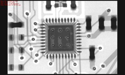

Board A does not exhibit any issue for any range of temperature it looks like this under XRay.
Board B exhibits the issue when the surface temperature of the chip is between 61C and 64C. Board B looks like this under XRay.
I got them XRayed in the hopes that voiding beneath the chip would explain the issue but puzzlingly Board A appears to show voiding to a greater extent than Board B.
The sample size is small but adding these vias does seem to have an effect. Boards without vias tended to show the issue in ranges centered in the mid 40s C and had wide ranges. This Board B is the only board to my knowledge to show the issue at such a high temperature in the 60s C and its range is very narrow at only 4C wide.
