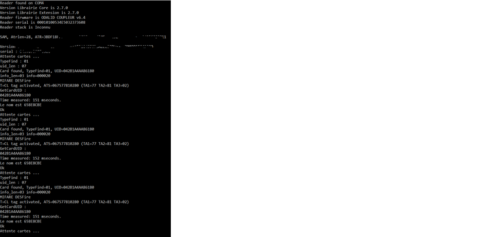

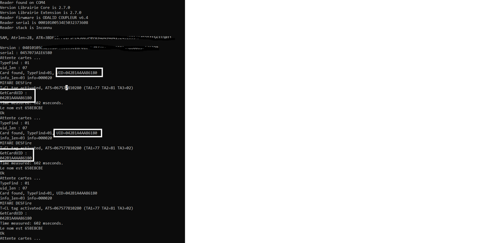

Hi Daniel,
I just did a test like this
-Identification
-Authenticate EV2 with software SAM
-ReadFile
-GetCARDuid
the uid card number is correct.
I use ComMode:FULL
which reader and software do you use?
Vincent

vincentthivent
Hi Daniel,
I use the ODALID library and readers
which library and reader do you use?
Which a DESFire Cartd you use? (EV1/EV2/EV3)
Is authentication EV2 or EV1?
Vincent
