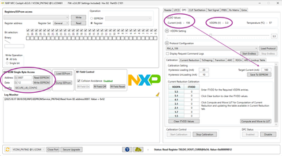

However, if the user's design is intended for infrastructure applications, such as a smart lock. At a minimum, Dynamic Power Control (DPC) should be enabled to serve as a current limiter.
The evaluation can be done with the help of NFC Cockpit.

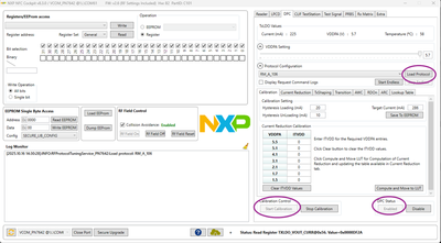

1// Start DPC Calibration
  • "Press" Start DPC Calibration
  • "Press" Load protocol
  • Make sure that the DPC is "Enabled"

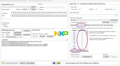

2// Adjust current reduction table
  • Set all entries to "0"
  • Write into EEPROM
3// Set the "Target" current
  • Use approx. the same current as "TxLDO Values"
    • The limit may be set higher, e.g., to 300 mA, if the purpose is solely to provide overcurrent protection for the IC.
  • Save to EEPROM
  • Restart the board (Close port -> Press VEN->Open port)

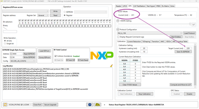

4// Check the power regulation
  • Start DPC Calibration
  • Place a card or any metal object in the antenna's proximity
  • Observe VDDPA and "TxLDO" current
    • The current should stay around the given target
    • The VDDPA will drop once the antenna is loaded

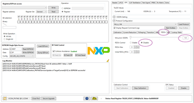

5// Set a minimum VDDPA in DPC
In the case that the current is still too high, a user can define a minimum VDDPA that is used for the DPC regulation. By default, this value is set to 2.2V. The user can decrease it up to 1.5V.
In that case, NXP also recommends disabling the RDOn control.
Note: The User has to consider the "DPC_TXLDO_MAX_DROPOUT" parameter, which defines the maximum voltage drop on TXLDO. By default, it is set to 3.6 V. That means if the user wants to use the minimum VDDPA 1.5 V, then the maximum TXLDO input shall not exceed 5.1 V. This feature protects the TXLDO from overheating.

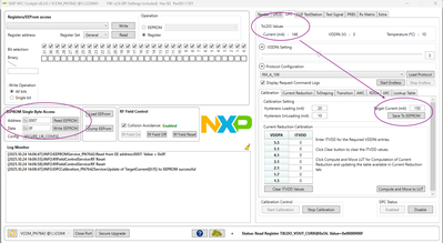

Once this is done, the user has to check the "TxLDO" current and adjust the target current accordingly. In this case, to approximately 150 mA. If you don´t change it, the DPC starts to limit the power around 229 mA, as has been set in a previous step.
