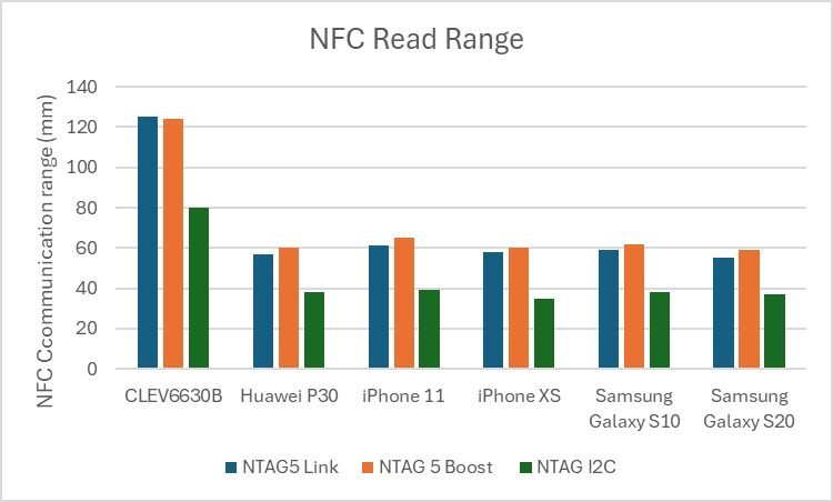

1// NFC Antenna 54 mm vs 27 mm (NTAG 5 Boost Antenna 10 mm vs 10 mm)
1.1// Used antenna
1.2// Results
Note: NTAG5 Link - Energy harvesting is disabled

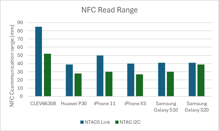

2// NFC Antenna 25 mm vs 18 mm
2.1// Used antenna
2.2// Results
