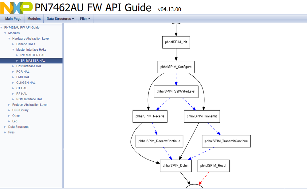

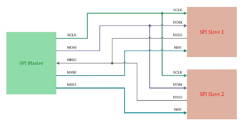

SPIM module is one of the master interfaces provided by PN7462 , which is a 32-bit ARM Cortex-M0-based NFC microcontroller, and users may use this interface to connect with up to two SPI slave devices.
The NFC reader library provides SPIM driver code in phHal/phhalSPIM, and users may directly use the following APIs in their application to implement simple SPI transaction, just like what is done  in the demo of "PN7462AU_ex_phExHif".

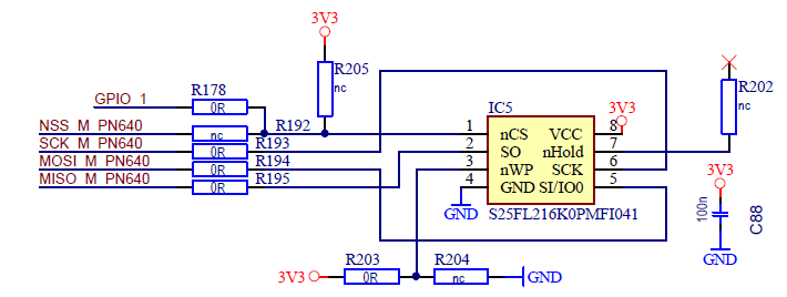

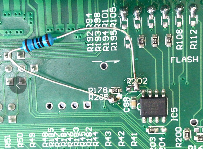

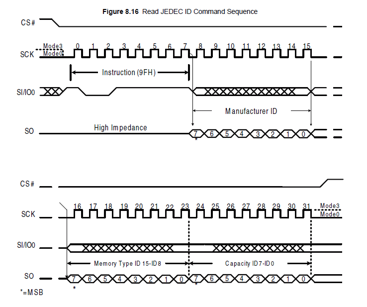

While this demo has limitation with some SPI nor flash devices, which need a write-read operation in one NSS session, for example, the SPI nor flash device on OM27462 as below:
Please note to solder R202 and connect it to 3V3 to make sure nHold pin has pull-up out of POR.
The following is one of the command sets this device supports:
This command contains 1 write(9F) followed by 3 read operations in one NSS session, but if you implement it with phhalSPIM_Transmit() and phhalSPIM_Receive() as below:

You will have the following result:
expected:
NSS   \__________________________/
MOSI     CMD A7-A0
MISO                            DATA
actual:
NSS   \____________||______________/
MOSI     CMD A7-A0
MISO                           DATA

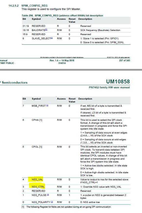

so the pulse between the write and read is the problem, and here we have to handle the NSS line manually, with the help of NSS_VAL and NSS_CONTROL bits in SPIM_CONFIG_REG.

The NSS line assert and de-assert function can be implemented with register bit level APIs, just like below:
            PH_REG_SET_BIT(SPIM_CONFIG_REG, NSS_VAL);//de-assert NSS
            PH_REG_SET_BIT(SPIM_CONFIG_REG, NSS_CTRL);
            PH_REG_CLEAR_BIT(SPIM_CONFIG_REG, NSS_VAL);//assert NSS

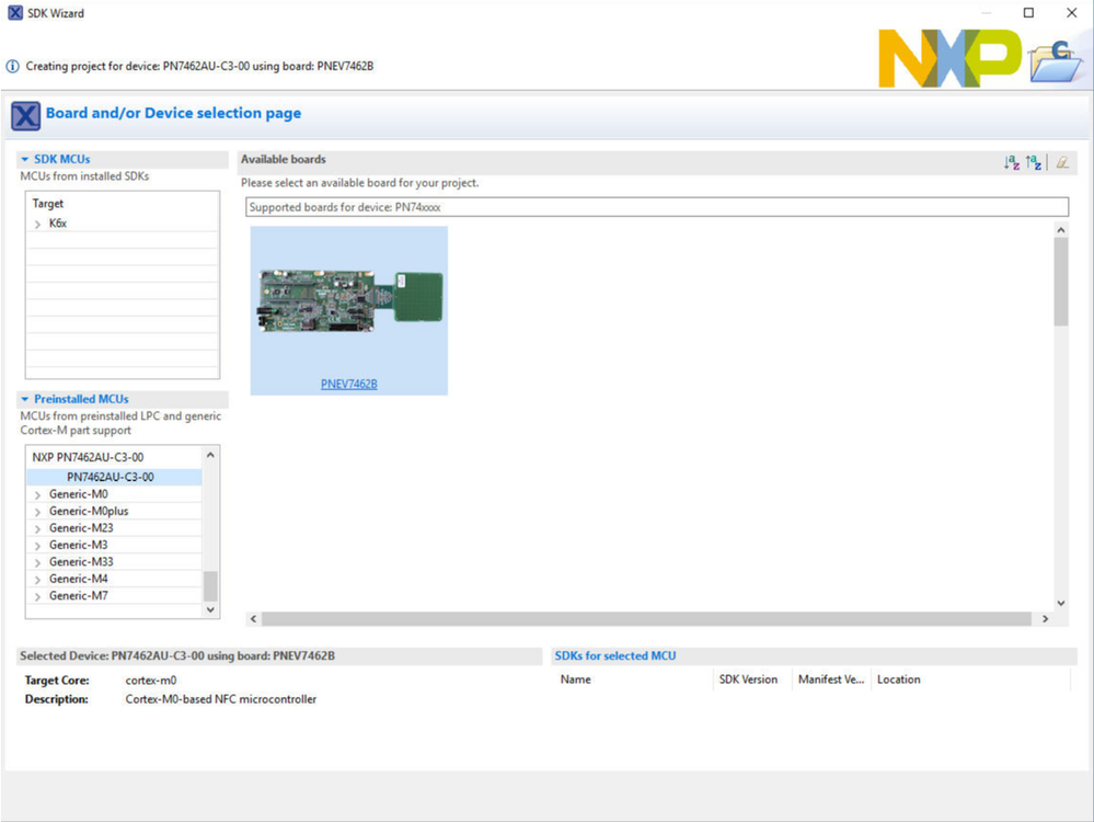

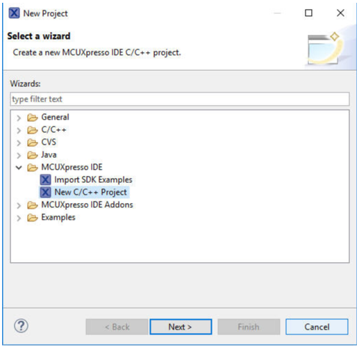

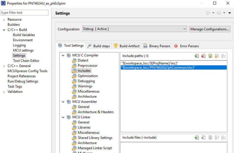

The following steps show how to create a new project based on NFC reader library, please refer to https://www.nxp.com/docs/en/user-guide/UM10883.pdf  on how to import the NFC reader library.
1. Create a new project after importing the NFC reader library.
2. if you installed PN7462 support package, you will see this:

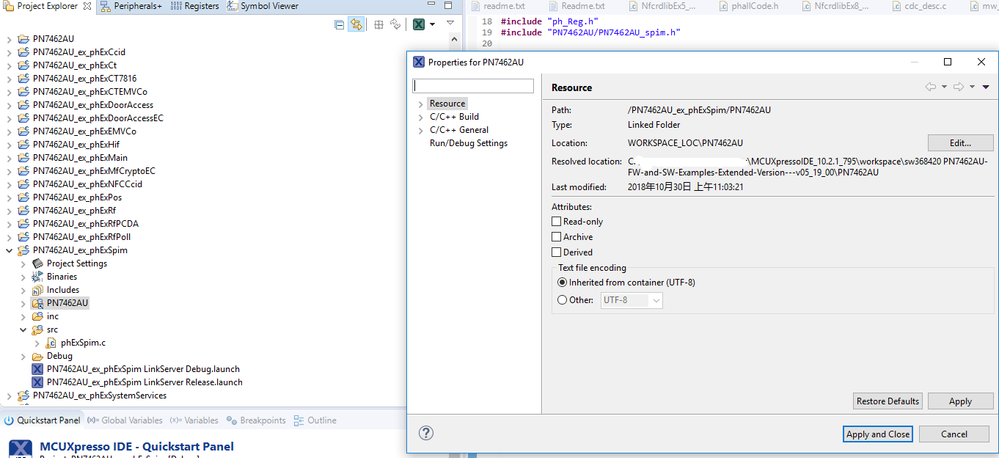

3. add a link to NFC reader lib:
4. add path and enable NFC reader lib in the project:

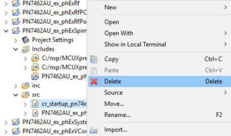

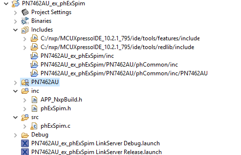

5. delete cr_startup.c and create the main code as well as the header file:

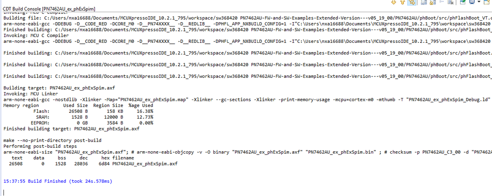

6. Build result:

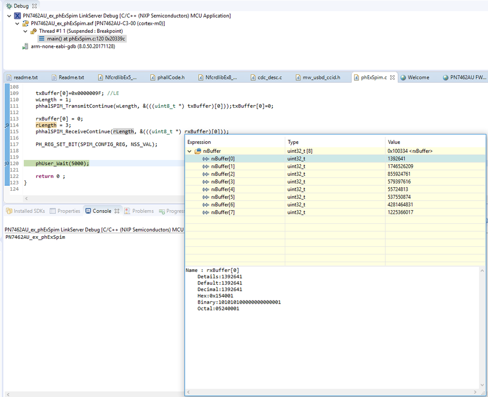

7.Debug result:
