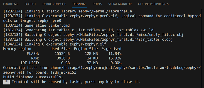

Building HelloWorld
To compile and build the program, click the Build button to build the Hello World project.
It's very easy.
Zephyr is usually built using the command line, with the build started with the West command, but it can also be built with a single build button in the GUI.
There's no need to remember complicated command options.
ビルドボタンビルドボタンBuild button
Once the build is complete, the memory capacity and usage will be listed.
Hello Worldプロジェクトのビルド結果Hello Worldプロジェクトのビルド結果Hello World project build results
