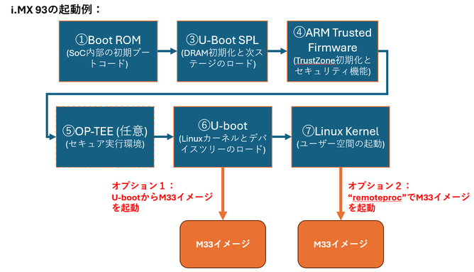

There are two ways to run an M33 core image from A55: "running from U-Boot" and "running from remoteproc," as shown in the figure below.
Now, I'll explain each method.

3.3 Running from U-Boot
This article explains how to load the M33 image on U-Boot and run it with the bootaux command. It also includes setting environment variables before starting Linux.

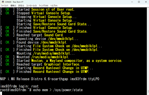

By performing the suspend/wakeup operation on the A55, you can check the cooperation with the M33.
On the A55, suspend it by running:
root@imx93frdm:~# echo mem > /sys/power/state
Enter the "W" command on the M33 to wake up the A55:
Confirmed return of A55:

3.5 Execution from remoteproc
Learn how to load, run, and stop M33 images using the remoteproc framework
① Run prepare_mcore in U-Boot , add clk_ignore_unused to the U-Boot mmcargs environment function, and start Linux.
