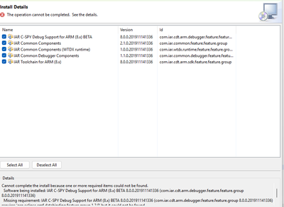

@Senlent
I tried to install EMF 2.13 as you suggested, still I have same trouble. Its showing operation can't be completed due to some missing requirement. details are given below snapshot.

Attaching the error message:

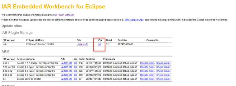

I tried manual installation, however ended up with error "cannot perform operation". I used update-site option for IAR-8.22 since I'm using the IAR-EW 8.22.1

Hi@AdarshRajendran
In the link you provided, you can see such description.
Manual installation using the "Install New Software..." dialog
The plugins can also be installed directly using the Install New Software... dialog, without using the plugin manager. To do this, you need to first lookup the update site to use which is compatible with your version of IAR Embedded Workbench version. When you have the correct update site, proceed with the normal Eclipse plugin installation procedure. Please refer to Eclipse documentation for additional information.

Attaching the error
