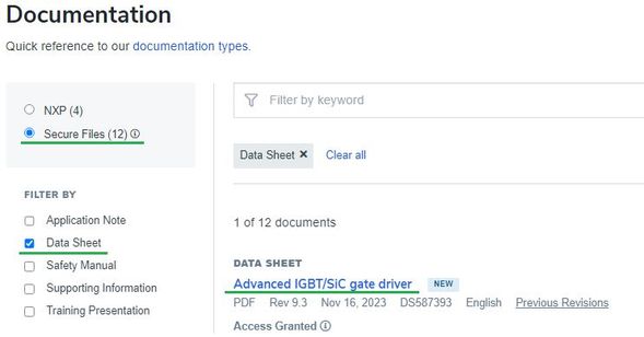

Currently, we are using six MGD3160AM315EK Gate ICs to export 3-phase PWM output.
We have two problems, so we're inquiring.
1. I want to use Gate Driver using SPI communication, but it has been confirmed that CS pin and CLK pin are coming out. However, I don't know what value to input into MOSI data.
I don't think there is any register information in the dataset. I was wondering if I could get a register map so I could set up the data.
2. It is detected that a fault signal is coming out. However, there is no problem in exporting PWM output.
I need an explanation about PWM going out when the fault signal is caught.
Thank you.

The GD3160 full datasheet includes the register map and bits description in Chapter 11.14. This datasheet is classified as a Secure File (requiring an NDA) and can be downloaded from:
https://www.nxp.com/products/power-management/motor-and-solenoid-drivers/powertrain-and-engine-contr...
As for your second question, please refer to the AN13129 - Fault management, diagnostics, interrupt and priority table of GD3160 advanced IGBT and SiC gate driver.
BR, Tomas
