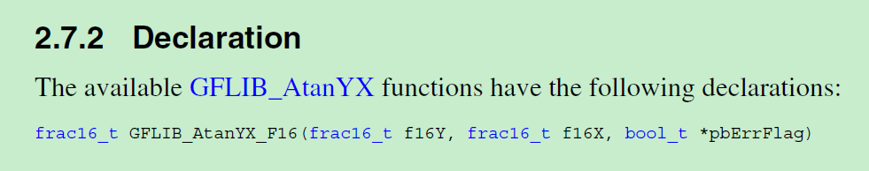

I'm using the CM4 version of the RTCESL library. The function GFLIB_AtanYX_F16 has an error flag as output type which the documenation claims to be a bool_t type that is 16 bit wide.
However, it seems the routine writes a 32 bit value to the error address. I've checked this with library versions 4.4 and 4.5 - both have the same behaviour.
Could you please check if other routines of the library using the bool_t type correctly as 16 bit value.

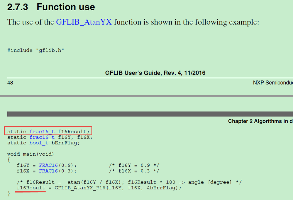

From GFLIB_AtanYX_F16 function declaration, the return value is frac16_t:
The use example also using frac16_t variable to receive the result:

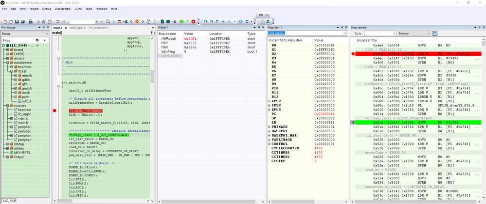

You don't need to generate an error because the function writes to the error flag if there is no error, too.
To simulate the error situation you need to declare bErrFlag as a 32-bit value like in this example:
static frac16_t f16Result;
static frac16_t f16Y, f16X;
static uint32_t bErrFlag;
void main(void)
   bErrFlag = 0x12345678:
   f16Y = FRAC16(0.9); /* f16Y = 0.9 */
   f16X = FRAC16(0.3); /* f16X = 0.3 */
   /* f16Result = atan(f16Y / f16X); f16Result * 180 => angle [degree] */
   f16Result = GFLIB_AtanYX_F16(f16Y, f16X, (bool_t *)&bErrFlag);
You will see bErrFlag is set to 0 by the function. This should not be the case if the function returns the error flag as a 16 bit bool type.

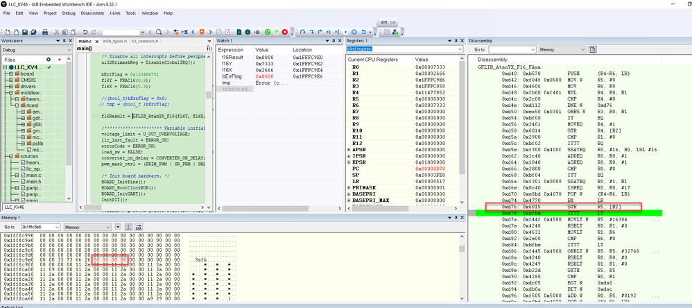

I debug into the GFLIB_AtanYX_F16() function and find it call STR instruction to transfer error flag.
Please check the address 0x1FFFC9E6 was written 32-bit data with STR instruction.
I also check the ARM Cortex M4 STR instruction, which store 32bits value to R2 register.
Thank you let us know that, I will report this issue to software team.
Mike

I found the same as you: the 32 bit STR instruction is used for clearing the error flag as well as for seting it.

I could regenerate your mentioned issue.
The uint32_t bErrFlag variable was totally changed with 16-bit value.
I need to discuss with software team about this issue.
