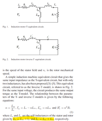

We have a three-phase induction machine (IM), of which we want to know the following motor parameters:
Rs:            stator resistance [Ohm]
Ls:             stator inductance [Henry]
Lm:           magnetizing inductance [Henry]
Rr:             rotor resistance [Ohm]
Lr:              rotor inductance [Henry]
For sensorless control of the IM, we use the AMCLIB_ACIMRotFluxObsrv and AMCLIB_ACIMSpeedMRAS. Rs and Ls are measured and verified - thus certain. However, executing the no-load and blocked-rotor test results in Lm >> Lr, Ls (magnetizing inductance greater than the product of stator- and rotor-inductance), which seems legit comparing to other papers and/or results found online. However, fltKrLsTotLeakGain from the AMCLIB_ACIMRotFluxObsrv ends up to be a negative gain in this way as the formula is:
((Lr * Ls) - Lm^2) / Lm
This seems to be faulty? Because a negative gain will not work out. What could be a possible cause?

Thanks for your post.
I believe that there is something wrong with your understanding. In the T-equivalent circuit, there is the following formula. For example, in the (PDF) On the Identifiability of Steady-State Induction Machine Models Using External Measurements
The Lm is the mutual equivalent inductance, it should be less than Ls, Lr. So the fltKrLsTotLeakGai formula in document CM7FAMCLIBUG.pdf is correct. Please check your parameter definition or test method.
Hope it can help you.
BRs,
Celeste
