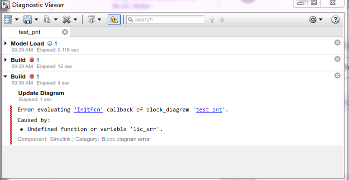

when I'm compiling an example of MBD, I got this error, Undefined function or variable 'lic_err'.

What should I do to get rid of it? Thanks!

ok!Problem was solved with the following post.
HotFix_2: Fix license errors for DISK_SERIAL_NUM with less than 8 characters
NXP Tracking numberAST-619
Problem: If your HDD has a serial number with less than 8 characters, the license checking and validation will fail even if the license is correctly generated
Root Cause: Coding logic error
Workaround:  Update the file attached in the following folder
{Toolbox install dir}\mbdtbx_pnt\mbdtbx_pnt\mscripts\matlab_ui\ folder mbd_pnt_hostid.p file
Customer Report: Undefined function or variable 'lic_err'.
