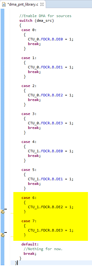

Two missing "break;" in the "dma_pnt_library.c" in ...\MBDToolbox\mbdtbx_MPC574xP\mbdtbx_pnt\src\c_library\
Just letting you know for a future update.

Hi markusransberger‌,
Thank you for reporting this issue to us. It is now logged in our database as: AST-794
