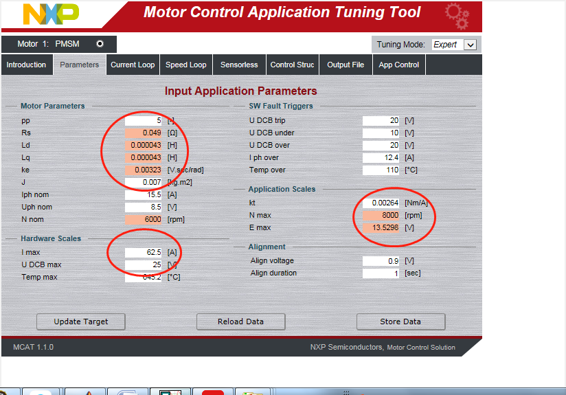

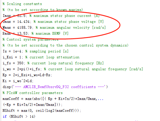

hi ,
 When calculating the parameters of the observer, if the motor and electrical parameters are exactly the same, according to the method in the document(MC9S12ZVMMCLUG), the result calculated by MATLAB is different from the result calculated by MCAT. Is that accurate?The picture is as follows:
I want to get your help ,thank you very much!!!
