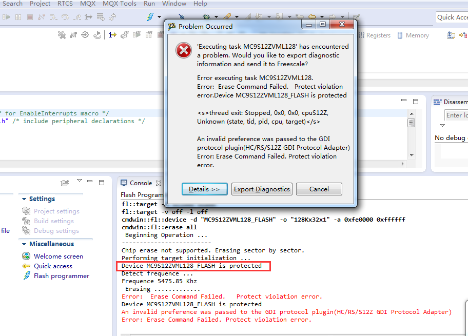

Hi,Dear Surpport:
I download the s12zvm.rbf  file into the S12ZVMx12EVB when I used the Motor Control toolbox  .
However I can't flash any other program into the board via BDM after finishing the s12zvm.rbf.
So I want to erase the bootloader while it 's been protected like the last picture.
Could you help me to solve this? Thanks very much.

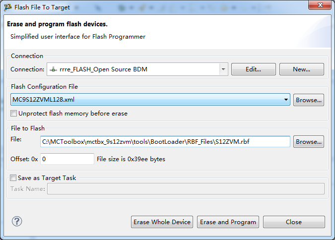

Have you tried to check the "Unprotect flash memory before erase" option ? Is it the same error ?
2,431 Views
jiangfeng
Hi, Daniel
First Thanks for your answers,
I just tried your methods, but it didn't work well ,like the following picture.
2,431 Views
Daniel_Popa
Hi jiangfeng‌,
What about from Matlab ? Does it still work to download an application into the flash memory this way ?
I want to check if this is a system issue or is just an issue with flash operations from CW IDE.
