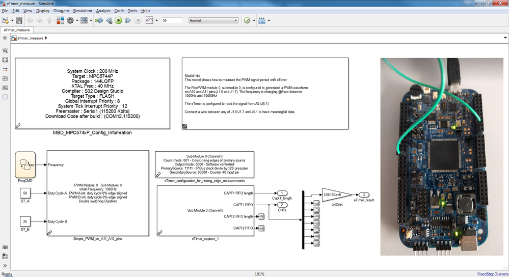

The application is going to configure the FlexPWM module to generate a PWM signal that changes its frequency between 1000Hz and 10000Hz. The PWM output pins used are A10(J1.5) and A11(J1.7)

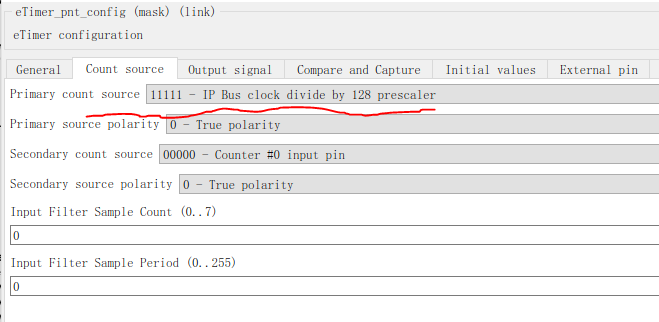

The eTimer modele is configured to read the input pin A0(J5.1) and measure its rising edges based on IPBus clock (160Mhz) and a 128 prescaller.

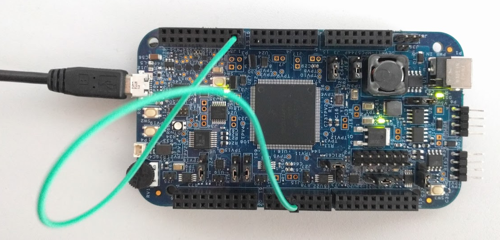

- MPC5744P DevKit
- Connect a wire between A10(J1.5) to A0(J5.1)

- Model Based Design Toolbox for MPC5744P v2.0
- Simulink model attached
- Matlab 2015b or newer
- Freemaster 2.0 for data visualization

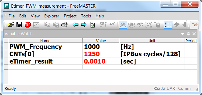

Verification:
- Build and Download the application to the MPC5744P microprocessor

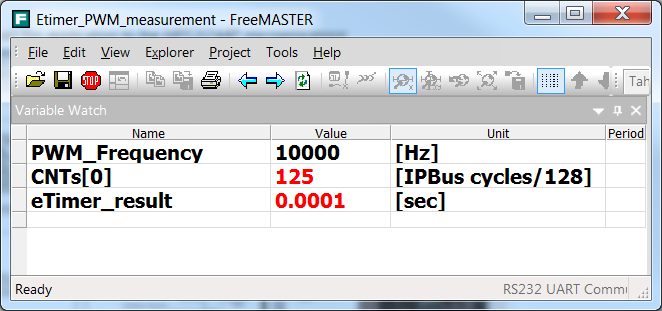

- Open and connect the Freemaster project attached. You should see:
@10000Hz
@1000Hz

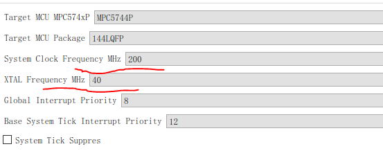

Hi Daniel,
     In your example ,I can't derectly find that  IPBus clock is 160Mhz .How can I calculate the IPBus clock?55.PNG

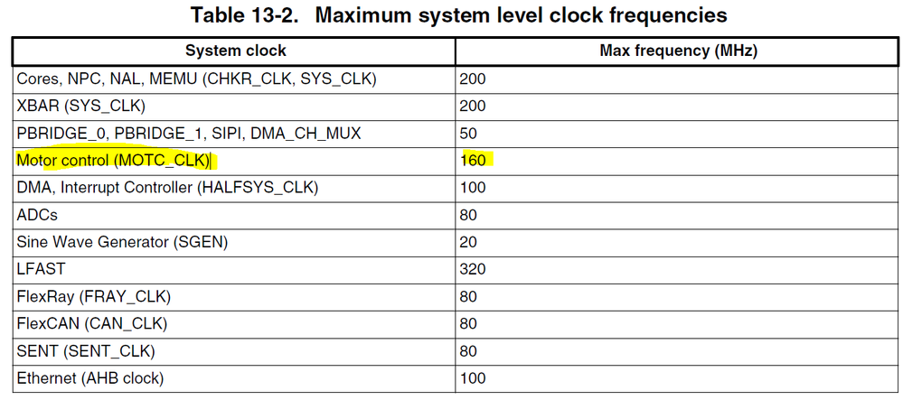

Hi @hjhjhj,
The IPBus is the generic name used for peripheral configuration. The source of the clock for each peripheral might be different. In case of the ETimer the IPBus clock is the MOTC_CLK. Please refer to the MPC5744P Reference manual. T
The maximum frequency of MOTC_CLK is 160Mhz.
In the generated code, the clock setup is made in the mcu_init.c file.
