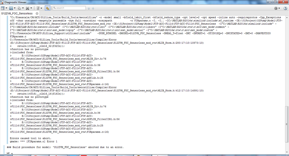

Some problems appeared when I generate code for the demo S12zvm_FOC_Sensorless.slx.
Could you help me to solve the problems in the following? I have use the default configurations.

Hi jiangfeng‌,
Sorry for delay.
What is the version of CodeWarrior IDE/Compiler you are using ?
I've tried with CW MCU 10.7 and it works fine. You can download it from here.
Hope this helps!

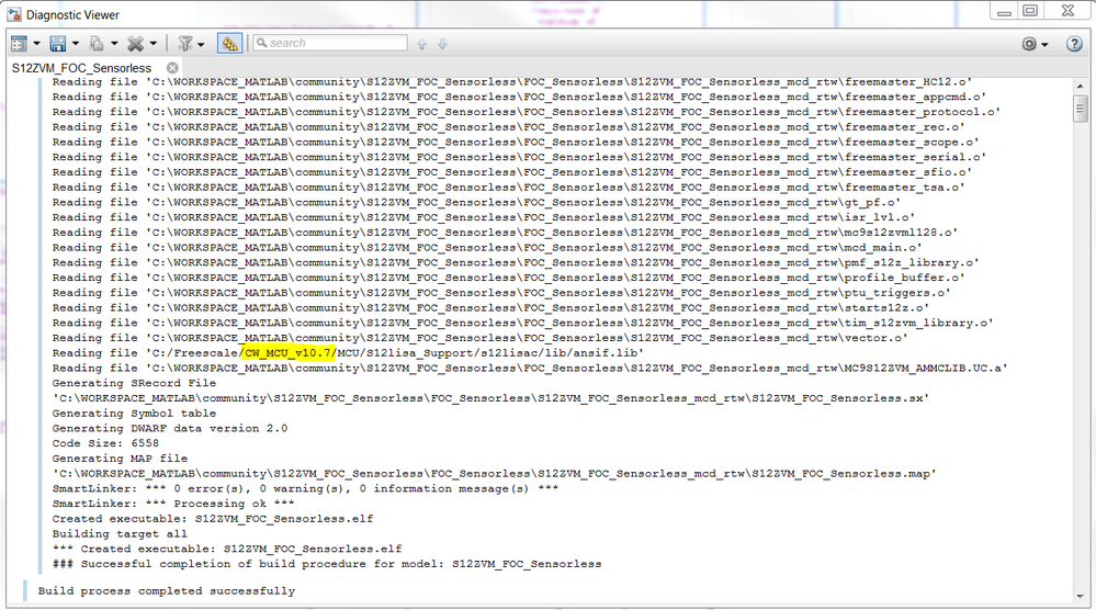

Could you send your S12ZVM_FOC_Sensorless.slx to me ? I want to try whether my application correct or not? Thanks very much!!
3,512件の閲覧回数
Daniel_Popa
Please find it attached - i used Matlab 2015b version to generate the code.

Hi,Dear Daniel
Thanks for your application,it works well
