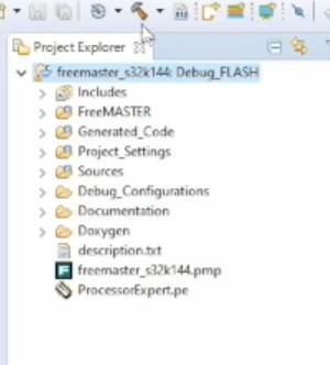

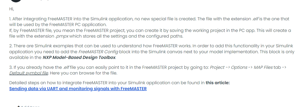

paul_ephraim_13
Kindly elaborate on the genreration of the .pmpx file for a simulink model for real time data analysis.Screenshot 2024-09-06 134727.pngScreenshot 2024-09-06 132211.png

Hi @paul_ephraim_13
For creating a .pmpx file to watch the evolution of your variables inside FreeMASTER, please check Chapter 6 FreeMASTER PC application of the following article https://community.nxp.com/t5/NXP-Model-Based-Design-Tools/Sending-data-via-UART-and-monitoring-signa...
As I also see this article referenced in the image you have attached to the thread, could you please share with us if you encountered any issues in following the steps described in there?
Thank you,
Irina

agus_idiada
Hello Paul, may be I can help you, the file pmpx is the extension file of a freemaster project that has the information of the configuration you already did in freemaster. As far as I understand, you can not upload it into a simulink model. Freemaster is to watch variables of the DSP with a deployed code. Hope it helps.
