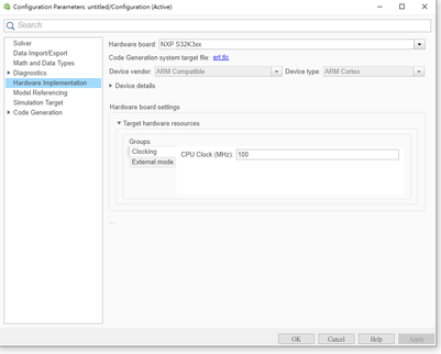

Dear NXP.
I upgraded MBDT 1.5.0 according to the S32K3xx1.5.0 Quick Start Guide and confirmed that each step was completed successfully. I make sure my license is in "lic" folder.
But I can't choose my hardware board in this version.
I tried again and again to reset the computer and simulink and even reinstall the toolbox, but the problem still cannot be solved.
I need to use the 「ICU Blocks」, so I need the latest version toolbox.
Can you help me and give me some suggest?
MBDT S32K312EVB-Q172

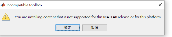

Hi, @SuperBeginner,
Thanks for sharing the installation steps, they helped to discover the problem.  You confirmed that you are using MATLAB version 2021a, instead I see that you are using version 2020b, a fact also suggested by the following warning dialog that specifies that the toolbox will be installed on a version of MATLAB that is not supported.

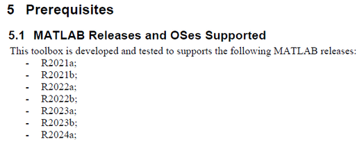

In the S32K3xx Release Notes document, the versions of MATLAB for which there is support are mentioned, starting from version R2021a.
In conclusion, I believe that this information will solve your problem with the installation of the toolbox version 1.5.0

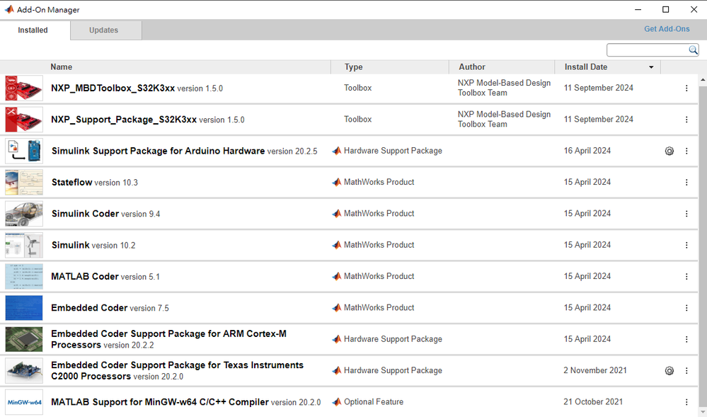

SuperBeginner
Hi @dragostoma
I found that the issue might be during the 'Verify MBD Toolbox License' step.
When I use the NXP Support Package and install MBDT1.5.0, I always encounter this warning.
Could you please help me understand how to resolve this issue?
My Add-Ones Managers is:
By the way, I have not any warning when I install the MBDT 1.4.0.
I need to solve this problem. I really need help.
Please help me, Thanks.

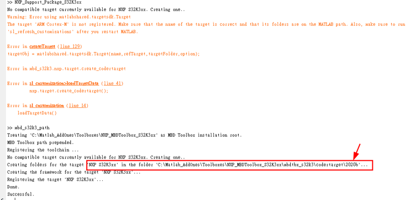

SuperBeginner
Dear @dragostoma
I have just tried to install MBDT 1.5.0 again and have taken screenshots of the installation steps as thoroughly as possible.
I also tried opening the example "s32k3xx_dio_s32ct," but the result is still the same.
I am still unable to configure my hardware.
Could you please take a look and see what might be the problem?
Thank you.

dragostoma
Hi, @SuperBeginner,
Dragos
3,577件の閲覧回数
SuperBeginner
Dear @dragostoma ,
This is my mistake. Thank you for helping me resolve the issue.

Hi, @dragostoma
Thank you for your reply.
I followed your suggestions, but the issue still hasn't been resolved.
Below is a response to your question
- Matlab  version- 2021a
- I can open ICU Model, but I can't change the settings in Hardware Implementation. It leads me can't do anything. This issue exists in both the example project and the new file.
By the way, Whether it's a example or the new file, I can't use ADC Blocks in MBDT 1.4.0.
It alwasy have error message which shows "ADC_.sldd has been changed on disk since it was opened. You should close it and any models that use it, and Simulink will see the changes next time the dictionary is opened. "
I can't solve it. Please help me.
Thanks.
