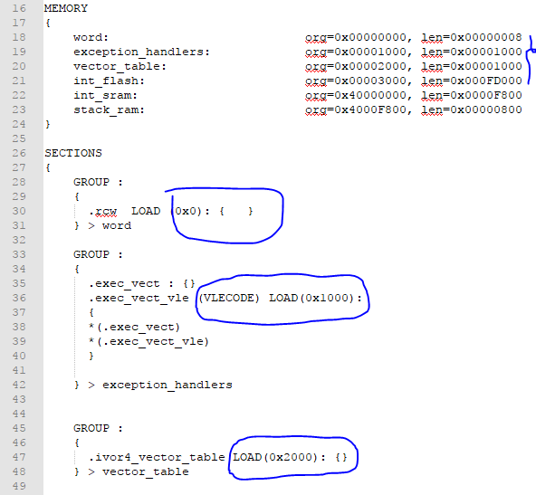

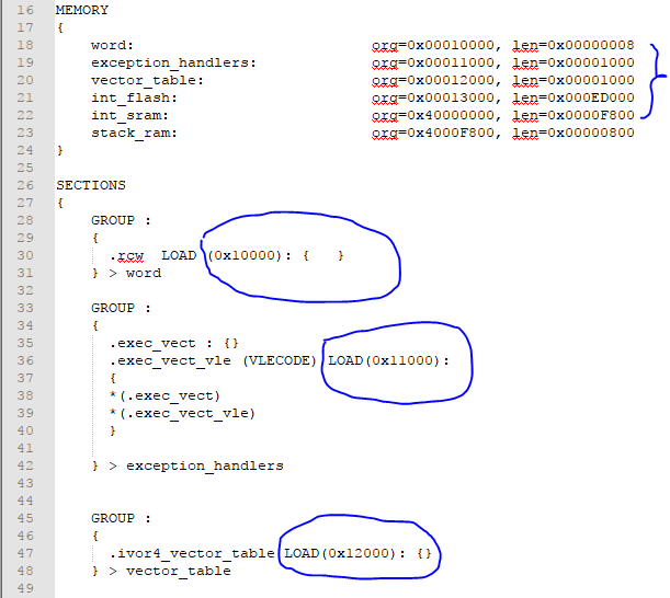

    Now I use the MCToolbox with MPC5643L.In the model I use FlexPWM without any modify,the program can run.When I modify the rappid_564xl_cw_flash_2013.tmf and the MPC564xLFLASH.lcf,the program can not run.
In the rappid_564xl_cw_flash_2013.tmf file,I modify in the below:
In the file I delete the '-romaddr 0x00003000 -rambuffer 0x00003000'.
In the MPC564xLFLASH.lcf file,I modify in the below:
In the modify file:
the old .lcf file

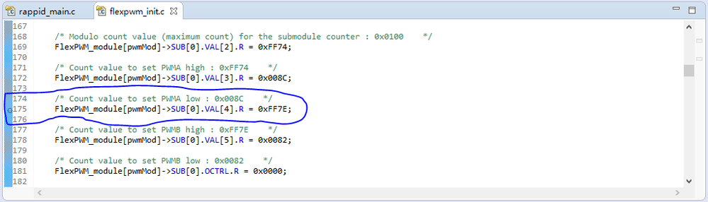

First I set breakpoint in the below:

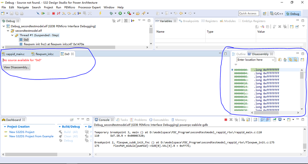

In the debug process.First I click the run button, the program go to the bteakpoint.Second I click 'Step over' button twice,the program only run one step and in the next step the program run to the 0x0.
I do not know how to solve the problem,can you help me?

I checked your project and it looks like you are placing data over a data section that is exclusively used by the Boot Assist Module (BAM)
In your map file is see:

I'm not an expert in how this processor works but i think that might be a potential culprit for the S32DS behavior you are seeing with 0x0 jump.
So, for the Simulink model settings i see no issues - the only questionable thing is the linker command file mapping. My advice is to get in touch with https://community.nxp.com/community/s32/mpc5xxx community since there are experts in MPC series. I think at this point is just a matter of setting the memory map correctly according with MCP5643L restrictions (which unfortunately i'm not fully aware off)
