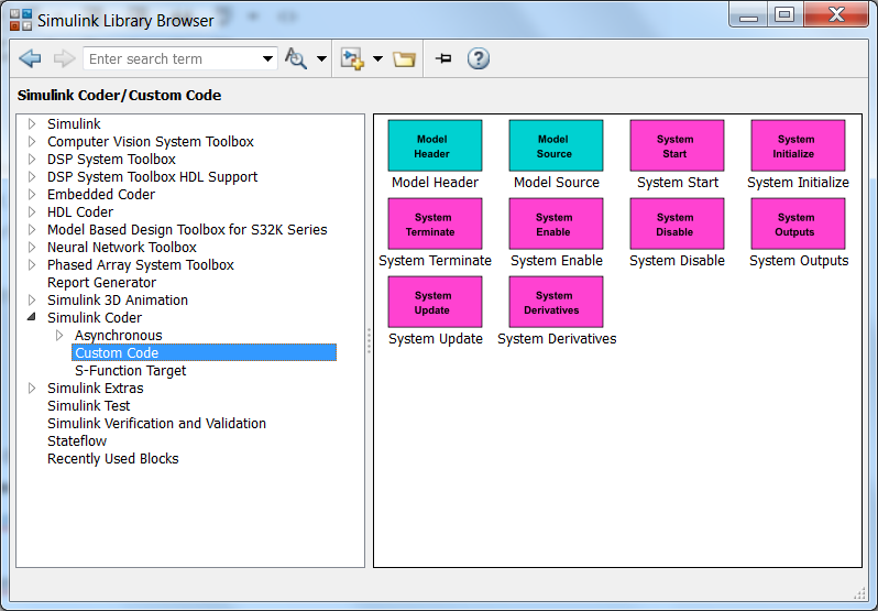

STAGE 1 (easy): copy all RTOS required files (sources + headers + libraries) into the Simulink Code Generation Folder. This can be done via mbd_pnt_user_copy_required_files.m what is automatically invoked during code generation. Check this for how to: https://community.nxp.com/thread/449904#comment-900775
STAGE 2 (tricky): invoke RTOS into the Simulink Model. For this you will have to use 2 basic approaches for custom/legacy code generation.
Anyhow, at this point i do not know how you could integrate Simulink models with RTOS without building re-writing the TLC behind some of the NXP's toolbox function blocks.
You might want to have a look here: https://community.nxp.com/thread/451648#comment-909339  for some additional insights.
