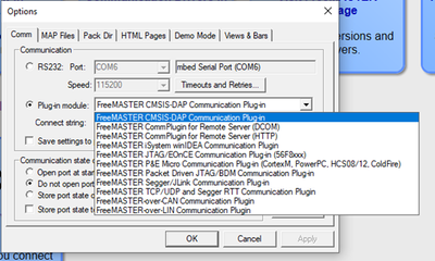

2. How can the USB-OTG be set up continue measurements with Freemaster, rather then running over OpenSDA with an additional MCU?
- Is it just a matter of activating the middleware in the .mex File. What configuration should be used?
- What is the correct configuration in Freemaster? (Will it be recognised as a serial port?)
