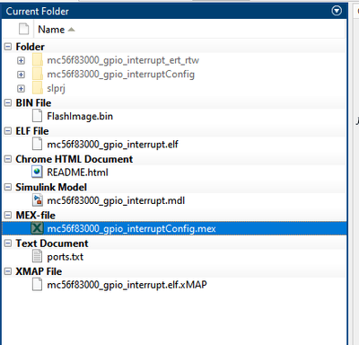

This problem looks like a bug on our side. Sorry for this inconvenience. To solve this issue, open the mex MCUXpresso ConfigTools file attached to the model and go to PIT configuration.
stefancinipeanu_0-1654152193190.pngstefancinipeanu_0-1654152193190.pngstefancinipeanu_1-1654152217853.pngstefancinipeanu_1-1654152217853.png
There you will see an error regarding to the timer Modulo value. Change that value to 1, as shown in the picture below.
Save this configuration file, go to Simulink, delete all files in the current folder without the mdl and mex files and then build your model again. It should build with no errors now.
