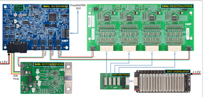

we are trying to connect the RD-K344BMU with RD33775ACNCEVB and . i am successfully debugging the hvbmu2_read_s32ct on the board but i noticed that the whenever i pause the code it stay in the loop :
i am not familiar with the Transaction Descriptor so that i do not know what it actually does. Can someone please orient me to what the problem can be ?
i am connecting the board as in the picture bellow:
attached is a copy of the Example Model i am using.

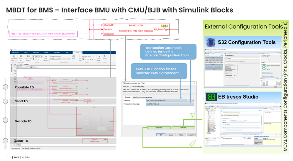

Transaction Descriptors represent the commands buffer which are sent and received over the bus between the BMU and CMU or BJB. The main idea here is that using the MBDT blocks you have to Populate the TD, Send the TD over the bus (and wait for a response) then Decode the TD, and finally clear the TD so that you have it empty for the next process. The image below shows how the interface with these blocks: Blocks need to be used in a certain order. If you open any of the blocks, then you can press the Configure button to launch the external configuration tool, and once these settings are performed, you have to press the Refresh button so that the blocks are updated with the new settings from the external configuration tools.

The image you attached represents the RD-HVBMSCTBUN kit and not the HWRD-HVBMSCC the one you might have thinking that you are mentioning that your board name is RD33775ACNCEVB.
There are two options here:
1. In the other post you requested how to modify the example from ETPL to work on CAN, I am going to give you the instructions on how to modify the S32CT example, but you have to run it on your side, because I don't have access to the HWRD-HVBMSCC kit.
2. To rapidly run the example you mentioned, you can still connect to the TPL, but you have to power up the 4x MC33775 via the emulator and via TPL connect ONLY the RD-K344BMU.TPL1 to the RD33775ACNCEVB.J30. In this way, the example you attached will only read the voltages for the CMU, and use the TPL Loopback as the main bus, so the MC33775 will be enumerated in the reversed normal order. Once you deploy the code on the board, just connect to the board via FreeMASTER as the example instructions suggest. Please don't try to debug it as is because the 775 will enter sleep mode.

Thank you very much for your response. I tried method 2 and now i can see Voltages.
Thank you for your suppor, i will be waiting for the instructions about how to modify the model so that i can use TPL communication.
For the BJB is the communication also standard or should i connect it otherwise ?
