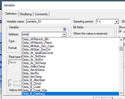

Step 1:
Tuning of the variables in Freemaster, but so that the signal names, parameters and lookup table names are as defined in Simulink (eg. Label, rather then Projectname.P_Label).
Incorrect:
Step 2:

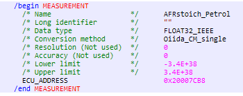

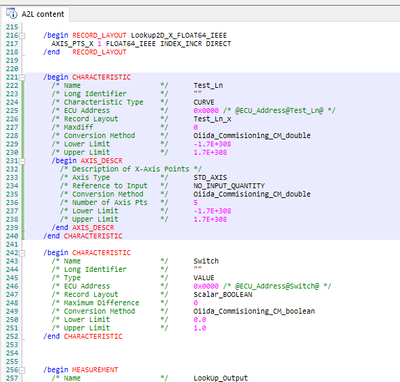

Generation of A2L file from simulink using the ASAP2 Interface with MBDT for iMXRT to allow tuning with external software such as INCA (with correct definition of addresses etc.).
Sam

For Step 1:
I've had good results with:
  • Parameters / Lookup Tables: Exported_Global
  • Signals: Volatile
Is there any reasons not to use these settings?
For Step 2:
The function in Matlab ">> rtw.asap2SetAddress('Project_Name.a2l','Project_Name.elf')" updates the generated A2L file from Embedded Coder with the Addresses:
