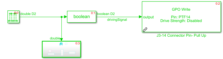

I am generating a pulse signal with a GPO (PF14) and trying to feed the pulse signal to PJ8.

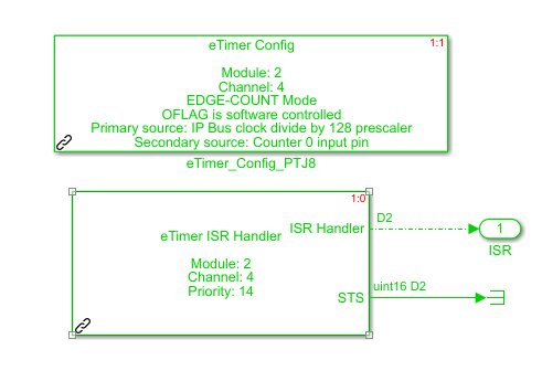

Use eTimer to detect the rising and falling edge from the pulse (PJ8 is connected to PF14)

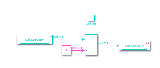

Use the EVENT for detection of edges to run a subsystem (where I add a counter every time a edge is detected)

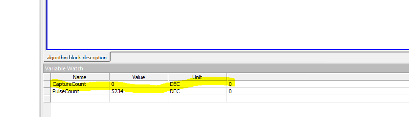

I expect the "CaptureCount" Value to be growing with every edge detection but in freemaster, the Counter stays at zero.
I think somehow the Rising and Falling edge events can not be captured, when I look on Scope PF14 values, it shows a pulse with 100 Hz frequency (which is intended). My best guess is that eTimer Configuration is wrong but I can't find where.

Looking inside your model, I found the following:
Firstly, in the model I've found that the Secondary source was selected the Counter 0 input pin, but in the pin configuration I've found that the PTJ8 was selected as the forth Counter pin. So, in order to use it please select the secondary Count source the "Counter 4 input pin" option. They must be linked together.
Secondly, I've found that on our side the pin initialization for the eTimer was not performed right, so please replace the attached p code script in the  src\mbdtbx_mpc574x\mbdtbx_mpc574x\mscripts\etimer location.

3,040 Views
abhishek_kumar1
Dear mariuslucianandrei‌
It works, Thank you for the input.
