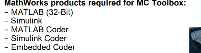

Hello, I am trying to get up and running to evaluate the MBD Motor control toolbox. The requirements list is as follows, which I have setup a 30 day eval with Mathworks to eval this:

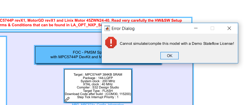

However when I run the MC toolbox examples, I get the following error, so is stateflow required or not?

The Stateflow is not a requirement for the usage of the toolbox but some of the examples may use stateflow diagram to implement state-machine logic, hence it is recommended to have such license.
The list of dependencies are listed on the www.nxp.com/mbdt page
The minimal system requirements are:
  • MATLAB & Simulink (in think this is obvious why)
  • Embedded Coder, Simulink Coder and Matlab Coder (needed for code generation for embedded MCU and/or legacy C code usage)
Anything else is recommended but there are ways to workaround by modifying the models.
