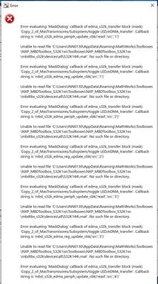

Also, everytime I try to load and configure the DMA block, I get this error message:
Maybe this is where is the issue that doesn't let me find the peripheral to configure it. Any idea how to fix this?
P.D.: I don't know if it helps but this is how my devices folder looks like:
Thanks in advance.
