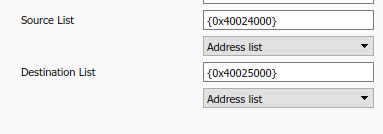

I have a CAN transmission system. I want to include a DMA, and I found the blocks in the library. I have a couple a questions about how to configure the parameters of the eDMA send block.
I am not quite sure what to put in the Source and Destination List.
Since I receive several messages over CAN 1 and send them over CAN 2, how can I know which memory address specify in here? I tried looking for the peripherals in the "Destination List Register Select" tab. But they never appeared here.

The model I am currently working on is just a simple test for making the DMA work with CAN. So it's only the CAN configure blocks and the DMA blocks. I am trying to receive the signal over CAN 0 and sending them back over CAN 1. And that's why I am using those addresses in the block.
I have a question regarding the scatter/gather transfer block (In the model PruebaDMA_SG). I tried to implement it but it doesn't work..I'm not sure which register and offset to use (in the Source/Destination List Register). I put the ones I think correspond to the MB5, so that's why I have those valies in the source register.

The problem with the error is solved.. thanks! Now my issue is regarding which register/direction to use in order to fill the parameters in the eDMA send block.
I tried the directions from the S32K1xx_Memory_Map but they didn't work.
And since I am going to use perihperals, I tried filling the data requested in the Register List tab, but I am not sure what to put in the register and offset spaces.
I am receiving data over CAN0, I tried the RXIMR0 because I thought it would be for receiving on the MB0, but apparently it is not like this. Can you tell me what is wrong?

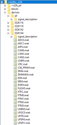

Also, everytime I try to load and configure the DMA block, I get this error message:
Maybe this is where is the issue that doesn't let me find the peripheral to configure it. Any idea how to fix this?
P.D.: I don't know if it helps but this is how my devices folder looks like:
Thanks in advance.
