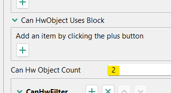

Hi.
I'm trying to send different IDs thorugh the same CAN PORT in simulink (s32k39 board), and I cannot find how to assign different buffers to each ID. If I use the same configuration for different IDs thorugh CAN, I can read the messages but at double rate of the frequency I have selected.
For example, if I configure 100ms as base task time, and I add two simulink blocks to send CAN Messages, I can see on the USB to CAN tool both message but at 200 ms. If I use only one sending block, I can see 1 message at 100ms, so I suppose that another can_buffer must be used, but I cannot find where to change it.
An example of a .mdl with several ID configured thorugh the same port will be appreciatted.
Miguel.
948 Views
Adrian_Gherca
Here are two methods to send out CAN messages with multiple IDs using the MBDT blocks:
First method:

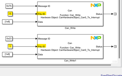

1) In your configuration project (S32 Configuration Tool or EB tresos), under Can_43_FLEXCAN\CanConfigSet\CanHardwareObject, increase the value of Can Hw Object Count to the desired number of Tx messages:
2) In the Simulink model add the same number of Can_Write blocks, each block with a different value for the Pdu ID input:

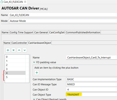

Second method:
1) Make sure that multiple TRANSMIT objects exist in the configuration project under Can_43_FLEXCAN\CanConfigSet\CanHardwareObject. If necessary, press the "+" symbol and create more at the end of the list:
2) Select a different Hardware Object for each one of the Can_Write blocks:

Thanks a lot. Both solutions work perfectly.
Miguel.
