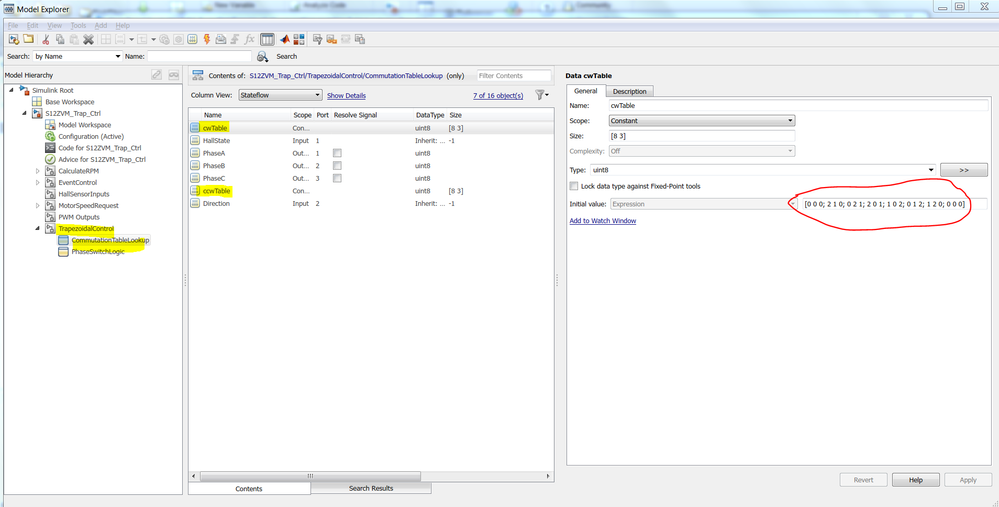

I used the program with hall-effect and sensorless program to drive the same motor with hall-effect,but I found that the sensorless program was better than Hall-effect, smoother and less noise.Besides  the hall-effect program has a smaller speed range .Could you tell me  what to pay attention to when using the program with Hall  to reduce the noise and spin smoother and a lager speed range?Thank you very much

Most likely the behavior you are seeing is due to the commutation lookup tables sequence. There are 2 commutation tables: clockwise table and counter clockwise table. You can find those under the TrapezoidalControl/CommutationTable Lookup/--right click Explore--
These values assume a specific correlation/interdependency between the motor phases and hall sensors. If those are not set correctly, the motor will still spin but most likely one phase is skipped - or putted in terms of motor control the angle between the stator and rotor magnetic fluxes is not kept at 90deg - basically the effect you are seeing. it's like a car engine running 3 pistons out of 4.
You could try to swap the hall signals and/or motor winding. That would be the simplest approach and you might have some luck and have it working fine.
My advice is to follow the Motor Control Class: Lecture 6 - Commutation and Motor Control Class: Lecture 7 - Commutation Algorithm to learn how to identify the proper hall commutation sequence and how to chance the default commutation look up tables to match your own setup.
