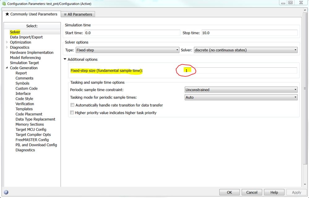

#2: check your project settings to configure the Fixed-step size (aka-fundamental time on which the STEP function) is called.

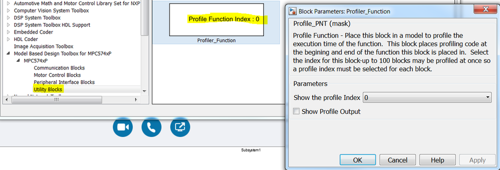

#3: Use Profiler function to check the number of cycles. There is a simple example about this:simple_profile_pnt.mdl
So, if you do the IO toggle on each STEP (let's say 1ms) you should see that on oscilloscope. Then using that as a reference you could add a second toggle IO in the same STEP and see on oscilloscope the diff between signals. That should represent how fast the toggle happens.
Then, keep in mind that the toggle actions is translated in multiple assembly instructions. If you have the diff and the number of assembly instructions you can then double check the 200MHz operation.
