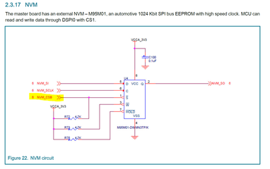

I would like to use NVM chip (M95M01-DWMN3TP/K) on DVCU5775EVM, so initially I have prepared simple model just to check chip status.

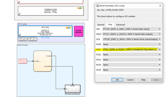

Chip is connected to SPI0 with CS1

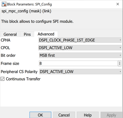

And I have used these settings for SPI blocks

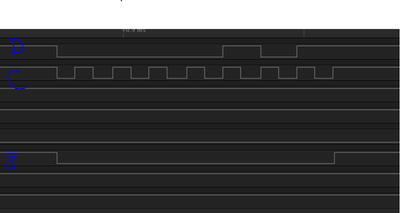

I had a look at your model and attached the model with a couple of changes. I don't have access to your board and I cannot test it, but I had a look at the signals using the logic analyzer. See the image attached below.
1.  SPI settings - for that you can select the CS pin in the SPI_Config, you don't need to change it by hand. To select the device you can select the CS in the Master transmit block, the one you have already used.
2. In the Stateflow, you can remove the chip select state, because the DSPI will handle that, so you can only send and decode the responses from the SPI.

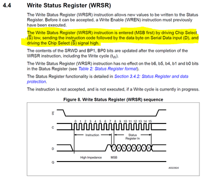

As per datasheet, we need to keep Chip select low while sending command and getting data from chip
Your image shows that Chip Select goes High after transmitting of command, am I right?
Is it possible to keep this signal Low until we will get data?

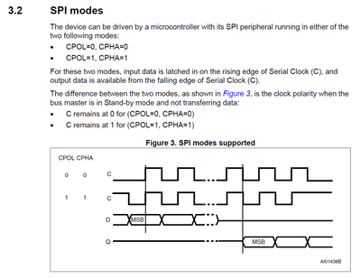

Another question, these SPI settings are correct
to provide one of following SPI modes?
Also, to send 8 bits command and 24 bits address I need to change SPI frame size to 32, am I right? Then how to change this frame size dynamically? For example to Read Status Register it is required only 8 bits, to Read data 8 bits for command + 24 bits for address, to Write data 8 bits for command + 24 bits for address + Data.
Input and Output ports have same size, so does it mean that we can only send/get SPI frames with same size?
